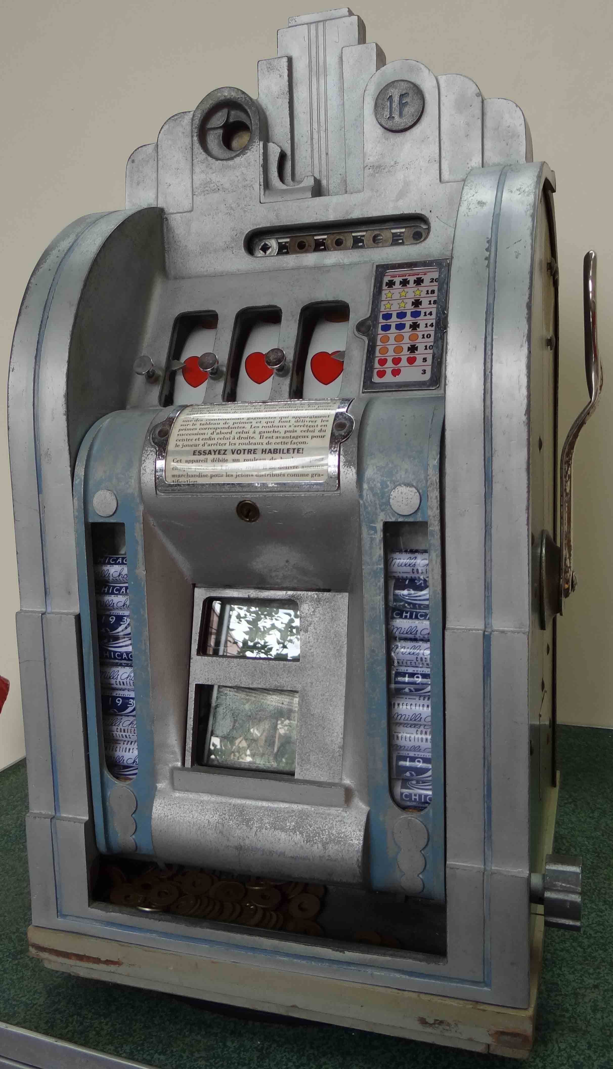

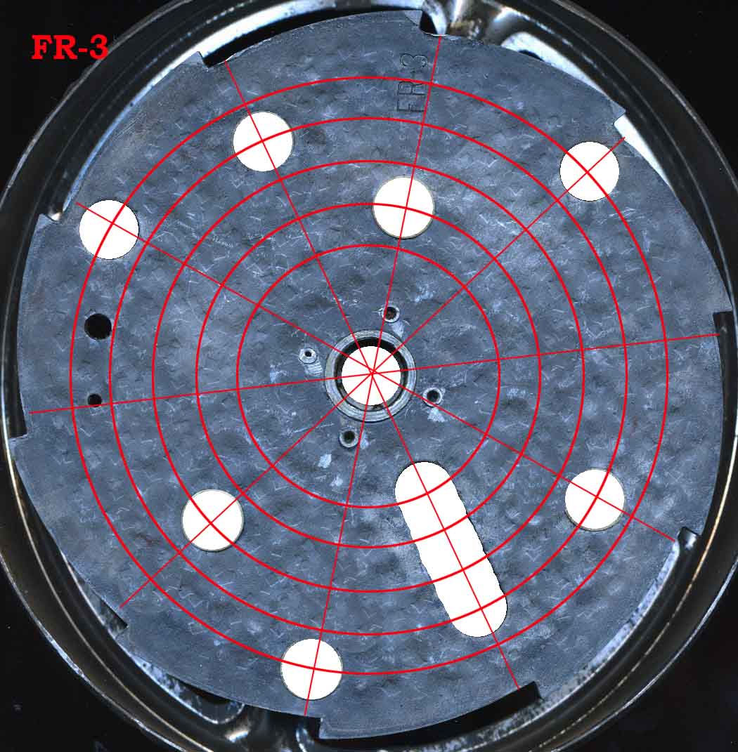

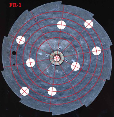

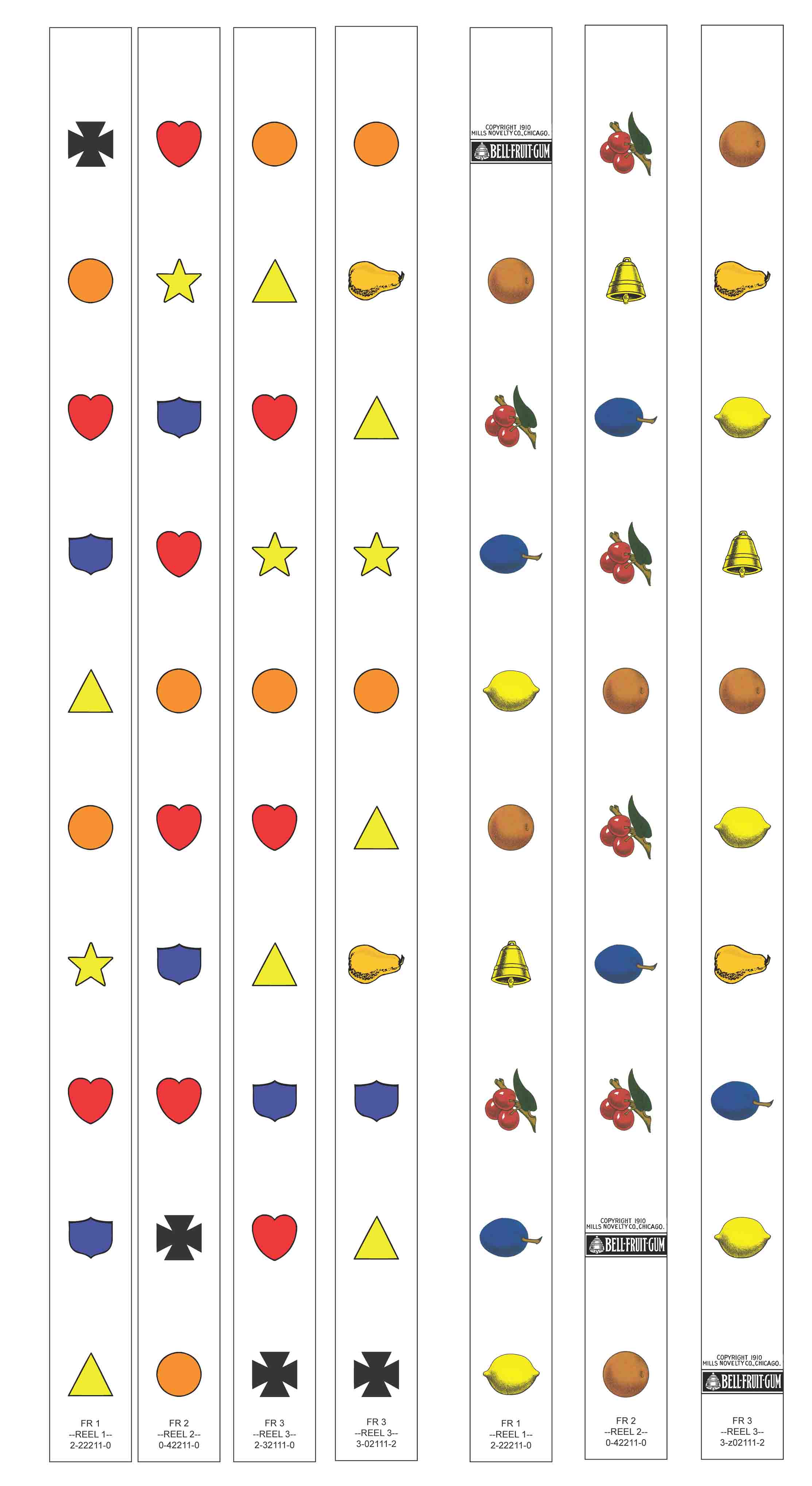

Hello
I have a problem with reels strip on my Mills ! #-o
It’s an complete ,unrestored and untouched Extraordinary ,in French version (1Francs) ,front vender ,no gold award , 10 STOPS ;but no reel strips ,no award card ! SN 3989** .

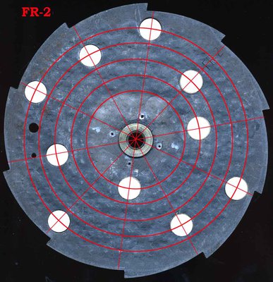

The problem: It’s a very strange bundle ! Disk are :FR1;Fr2;FR3 ,in 10 stop ,with 4 rivets and not 3 as the early version !
FR for “FRuit” or “FoRtune Teller” or other ??
I have not found any info on this !! And the reel 3 are very special ! Just one hole for the bell ,so you can win 3 coins only for “Cherry,cherry,Bell” not 5 !And two stop with “no hole” ! Maybe for a new symbol like a Pear.

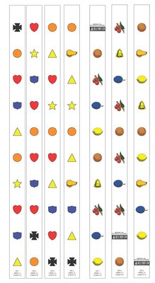

This is a scan of the three disk! And a test of strip that I mind, and award card!
Tell me if I’m in the good way, or if you have any info about this strange Bundle ?!Please HELP ME !! [-o<
I hope that my English is not too poor !!Sorry for this !! :oops:
Thank you
Stephane

Postby oldslotman » Mon Jun 15, 2015 10:22 am
The reel strips with the fruits and bars on them will not work. the first three reels strips with the symbols on them should work.
Reel 1 2-22211-0 Reel 2 042211-0 Reel 3 2-32111-0

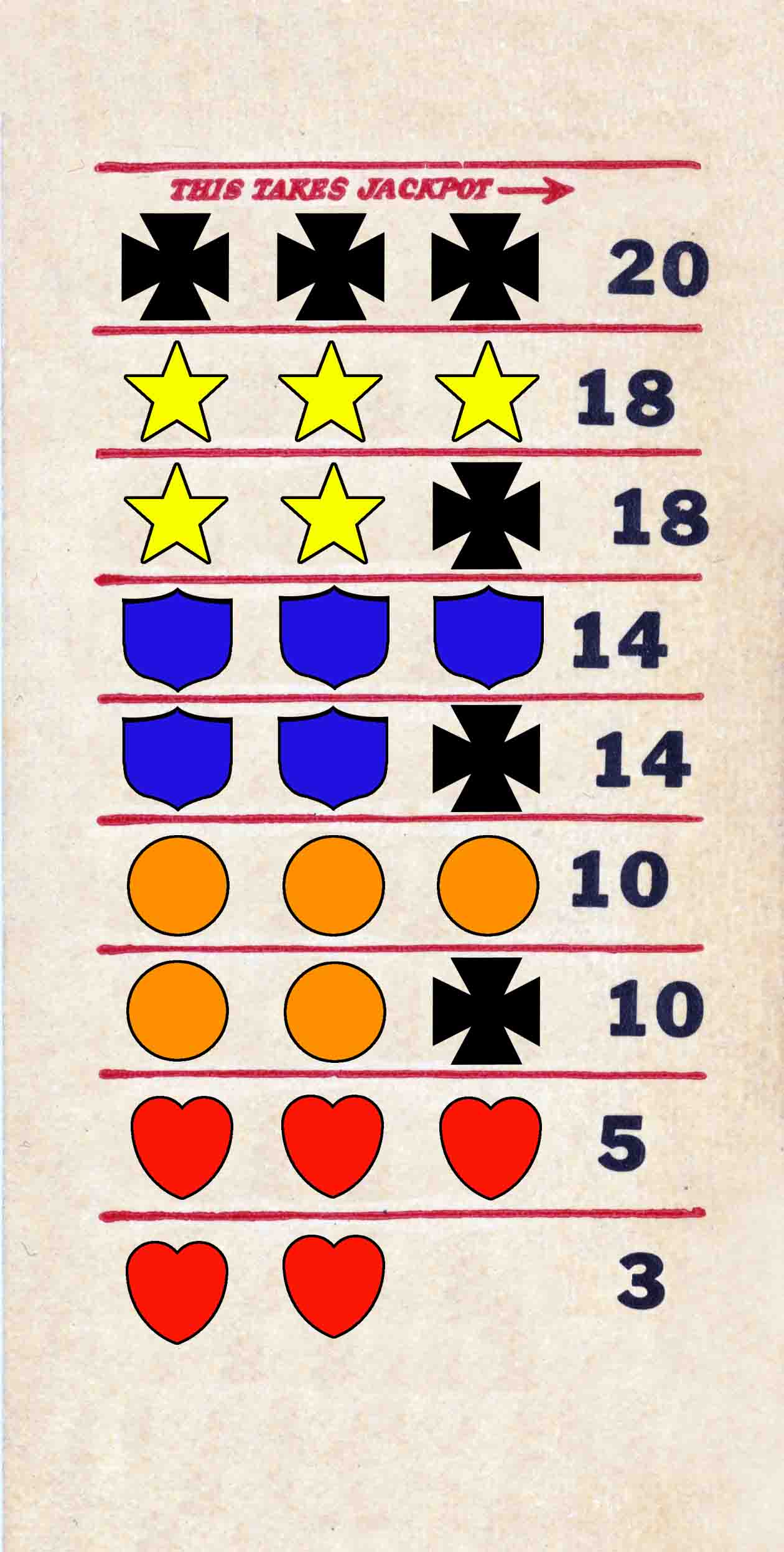

Possible payouts:
Red--------------------- ??? XXXXXXXXX Disregard.
Red Red -------------- 3
Red Red Red -------- 5
Orange Orange Orange ------ 10
Orange Orange Black --------- 10
Blue Blue Blue --------------- 14
Blue Blue Black ----------- 14
Star Star Star -------------18
Star Star Black --------------------- 18
Black Black Black --------------- 20
The Yellow triangles have no hole so they are the same as a Lemon. Should have no payouts if a yellow triangle is present unless it pays on one or two reds and the yellow triangle is on the third reel.

Re: Help on Strange reels strips Mills Extraordinary
Postby Midcoast Vintage » Mon Jun 15, 2015 11:26 am
There were those strange "fortune only" strips that came in 2 varieties; one with the fortunes in a shield shape, and the other with the fortunes printed over colored squares.
I have seen them on extraordinary machines years ago.
Could these possibly be the strips for these discs?

Postby oldslotman » Mon Jun 15, 2015 2:14 pm
You could use the fruit reel strips if you drilled a hole for the bell in the cherry position on the third reel strips.

- I keep fruit symbol , with a Pear symbol on the reel 3 and this award card (pay 3 for cherry cherry bell !) !But I m not sure that the Pear was a Mills Symbol !I know that Watling use it ,but not sure for Mills !
- or I use the other symbol with this award card ,but look as a very very strange award card !
What do you think about the best and realist way ??
Thank you
Stephane
gsx11r
Posts: 242
Location: France, Paris
Postby oldslotman » Tue Jun 16, 2015 12:42 pm
I would do the second award card. You would not have to drill the disc. I just wouldn't like that pear. I just think that award card looks nice, plus you are not changing that third reel disc.

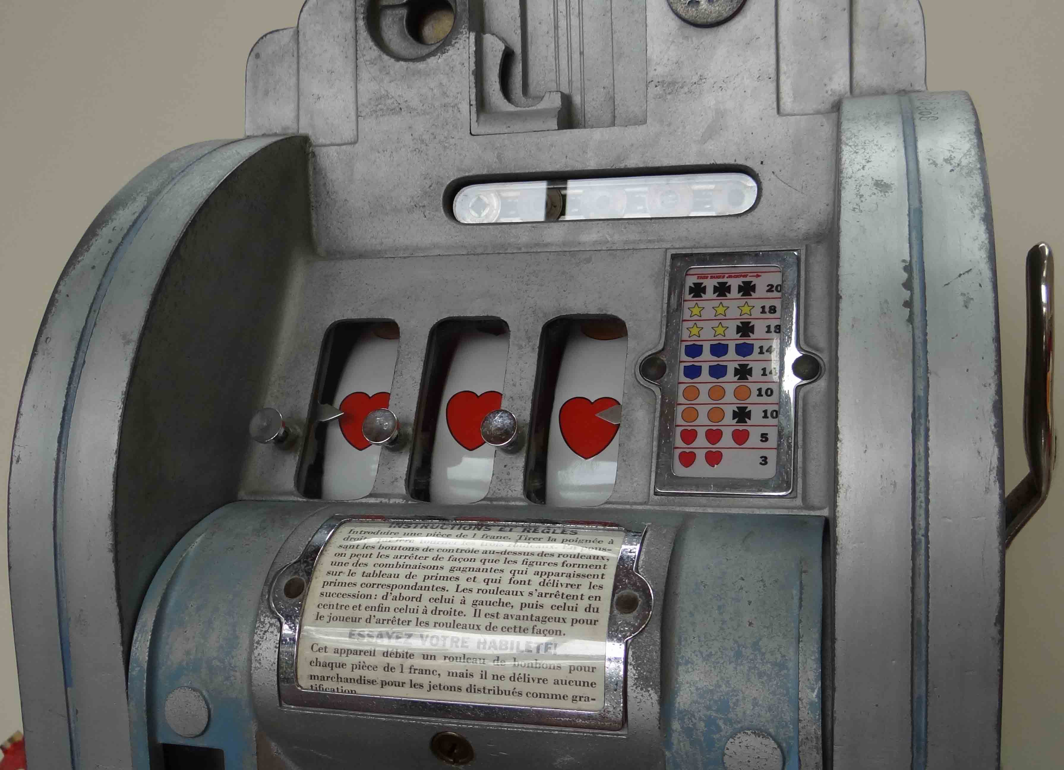

Postby gsx11r » Mon Jul 20, 2015 10:03 am
Hello
I m Back with my strange Extraordinary !
It s finish !!
I have not drilled the disks ,I kept the "symbols" solution !
Thank you for your comments .
Stephane
