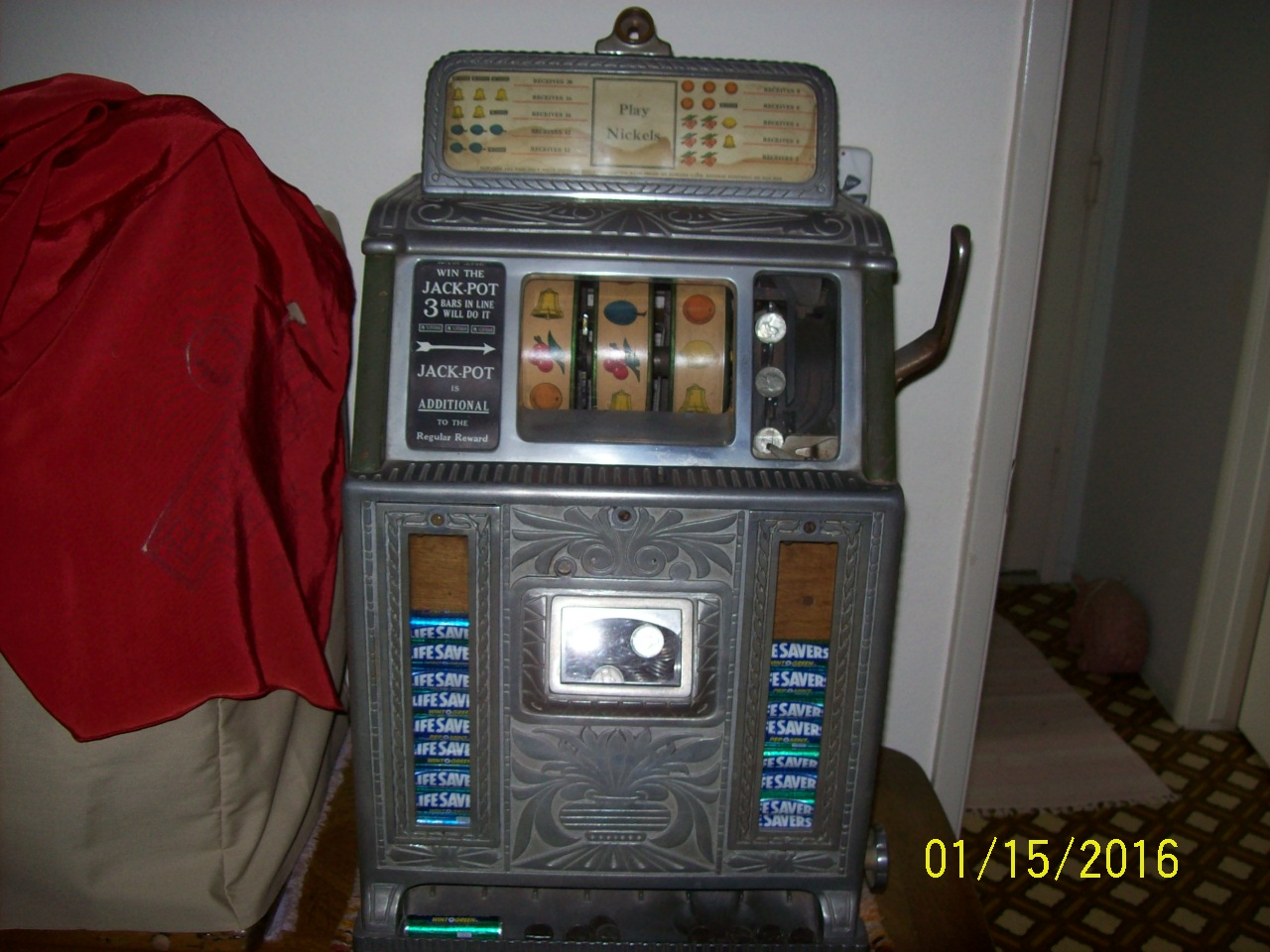

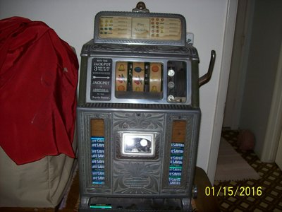

Postby TJ » Fri Jan 15, 2016 11:39 am

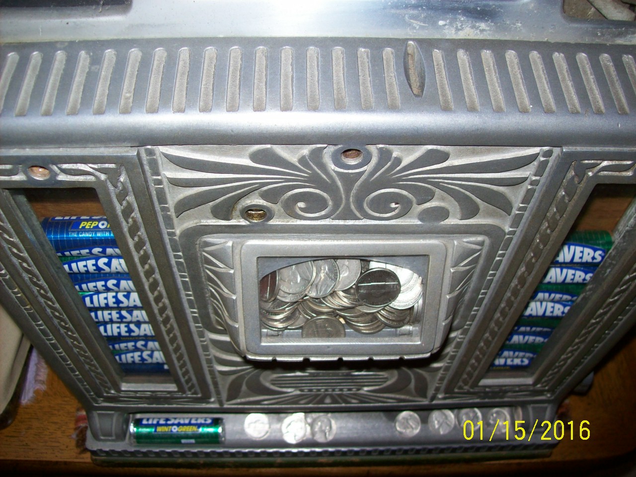

Thanks for the pictures. My Superior has a hand load front casting would like to find a jackpot for it . A key opens a nickel size slot just above the jackpot window. Another variation.

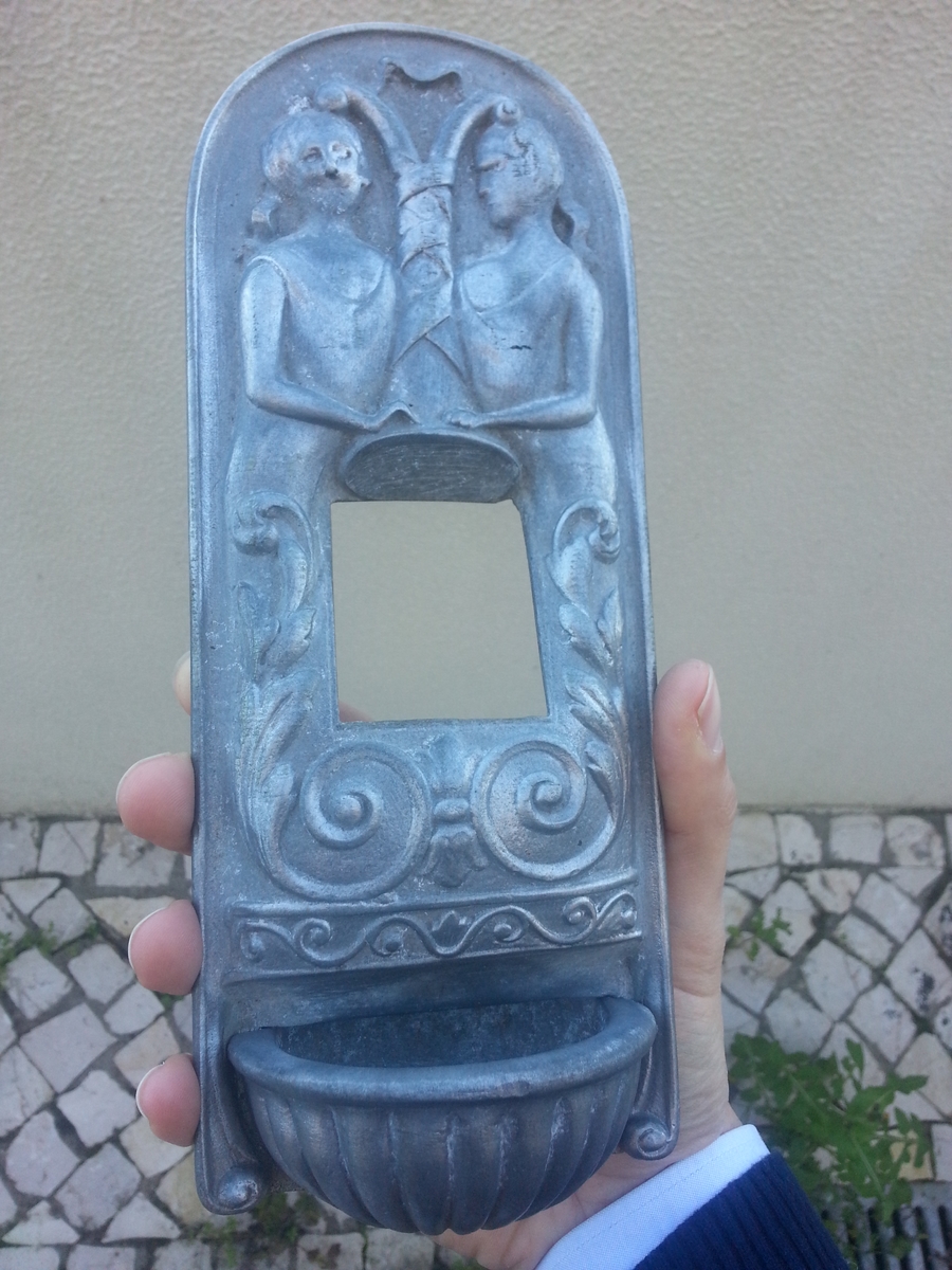

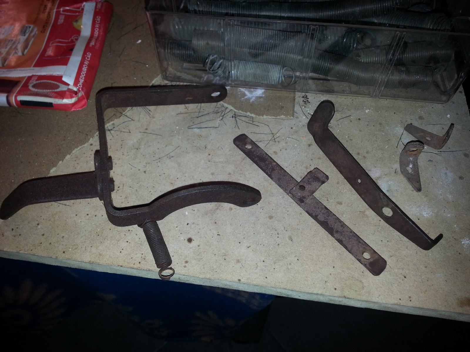

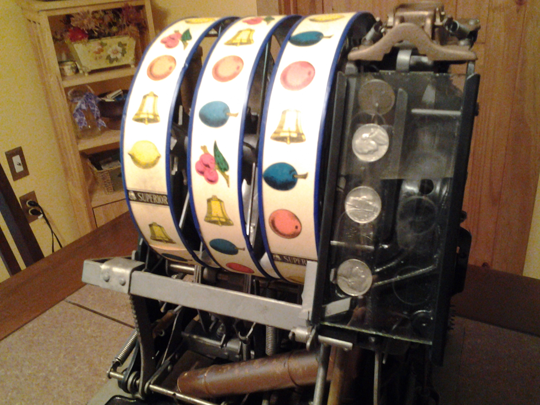

Postby MaverickPT » Sun Jan 17, 2016 5:08 am
Hi to All!

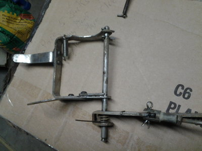

here are some parts that i dont know where to fit in the superior bell.
maybe you can help me on this.
I spent some time with the mech and i got it cycling again!! thats good because i was not certain if it had enough parts to work properly.
with or without parts, it is a surviver, and its worth to bring it to life again.

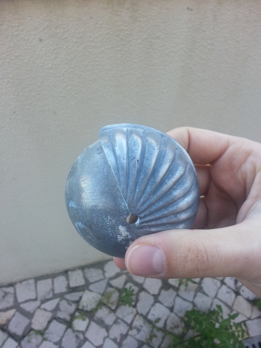

Here is the jackpot casting in detail, its very beautifull and perfect fit!! in my opinion too good to be made by european adaptation or revamp, but still i guess we will never know.
the metal is exactly the same or very similar to the rest of the castings.
The jackpot mech still is a mistery for me, it has some kind of reel that rotates probably to divert the coins from the jackpot to the cashbox.
The reel has a gear like the clock gear to avoid it turning back. I figured out how the jackpot fires and it will.
here are the photos

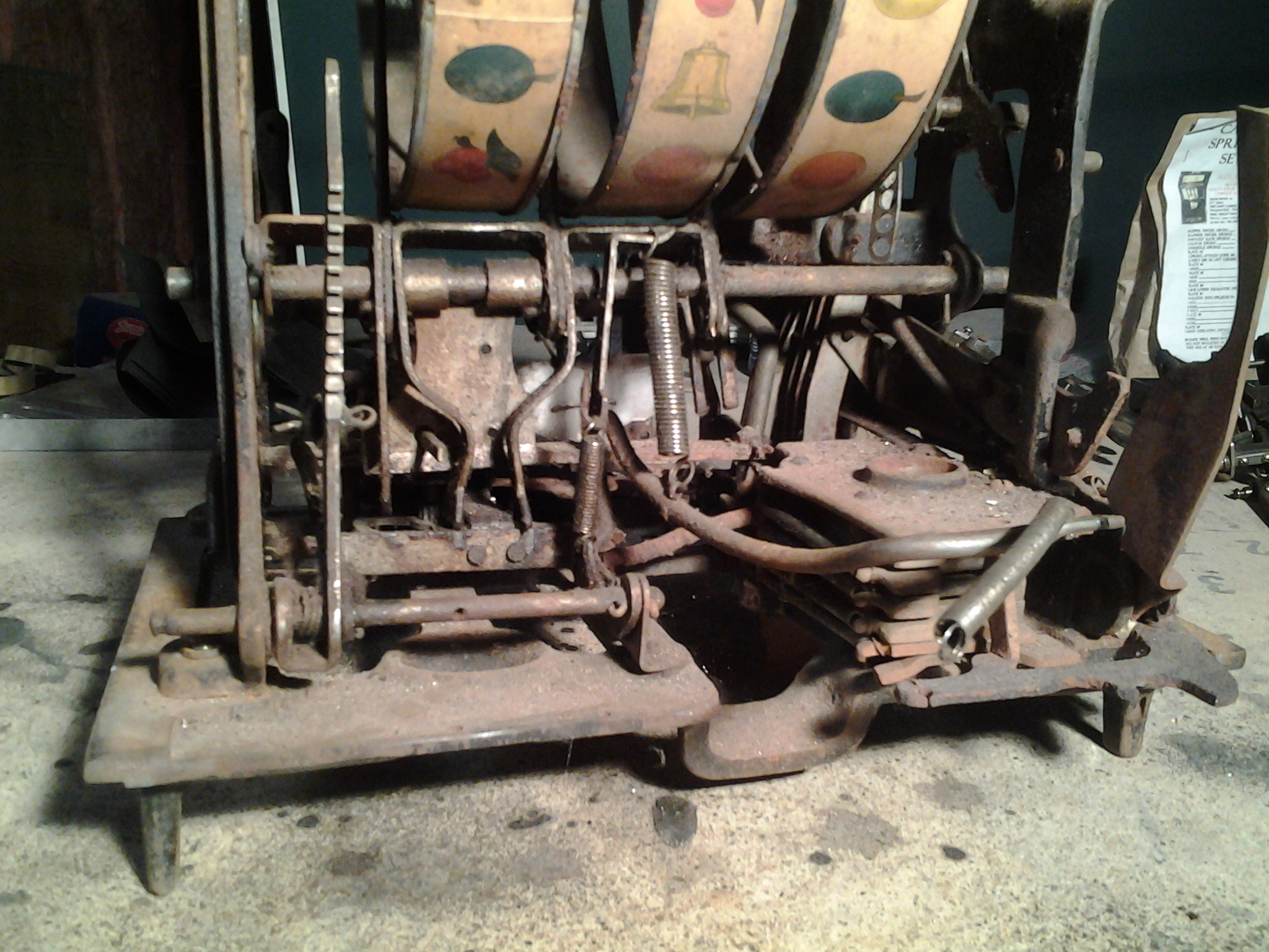

Postby MaverickPT » Sun Jan 17, 2016 5:38 am
Hello again,

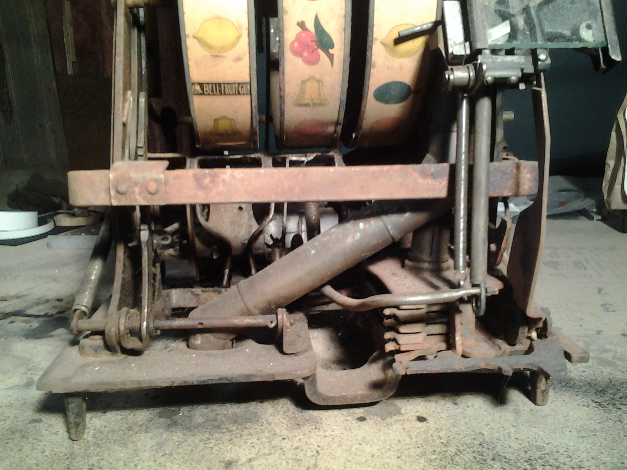

i found something strange...
when played, the machine only starts when the handle is released. Is this supposed to be like this?
what i mean is the reel only start to spin when you release the handle after pulling it down.
Also, the reels start to spin UP (seen through the window position) and not down... or do i have the kicker mounted the wrong way?
these things are strange because all my machines start when the handle reaches the bottom position and all the reels start moving down (when seen through the window)
thanks for your advices!

Postby altort » Sun Jan 17, 2016 8:17 pm
I dont know if you have found the information that you needed for those parts that you have pictured, the "U" shaped part is for the reel stops, the tongue part rides against the clock, as the clock winds down the braket drops releasing one reel stop at the time, I will post some pictures of that part,

Postby altort » Sun Jan 17, 2016 8:40 pm
As far as your other post about the reels spinning backwards and not till you release the handle, I was looking at your pictures, the kicker is mounted correctly to the "A" frame and cant be mounted backwards, possible that a spring in on the wrong place, I was also noticing the lack of an escalator and what looks to be a chute to divert the coins it to the payout tube, trying to locate all the correct parts for a Caille mech is a challenge, for your very unique slot it will take quite a bit, fabrication and adapting parts to work for your application may be necessary.
