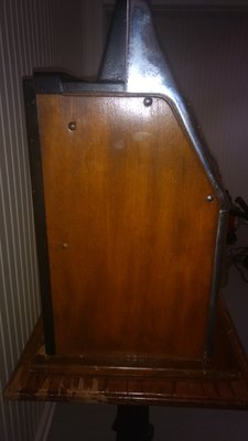

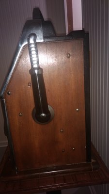

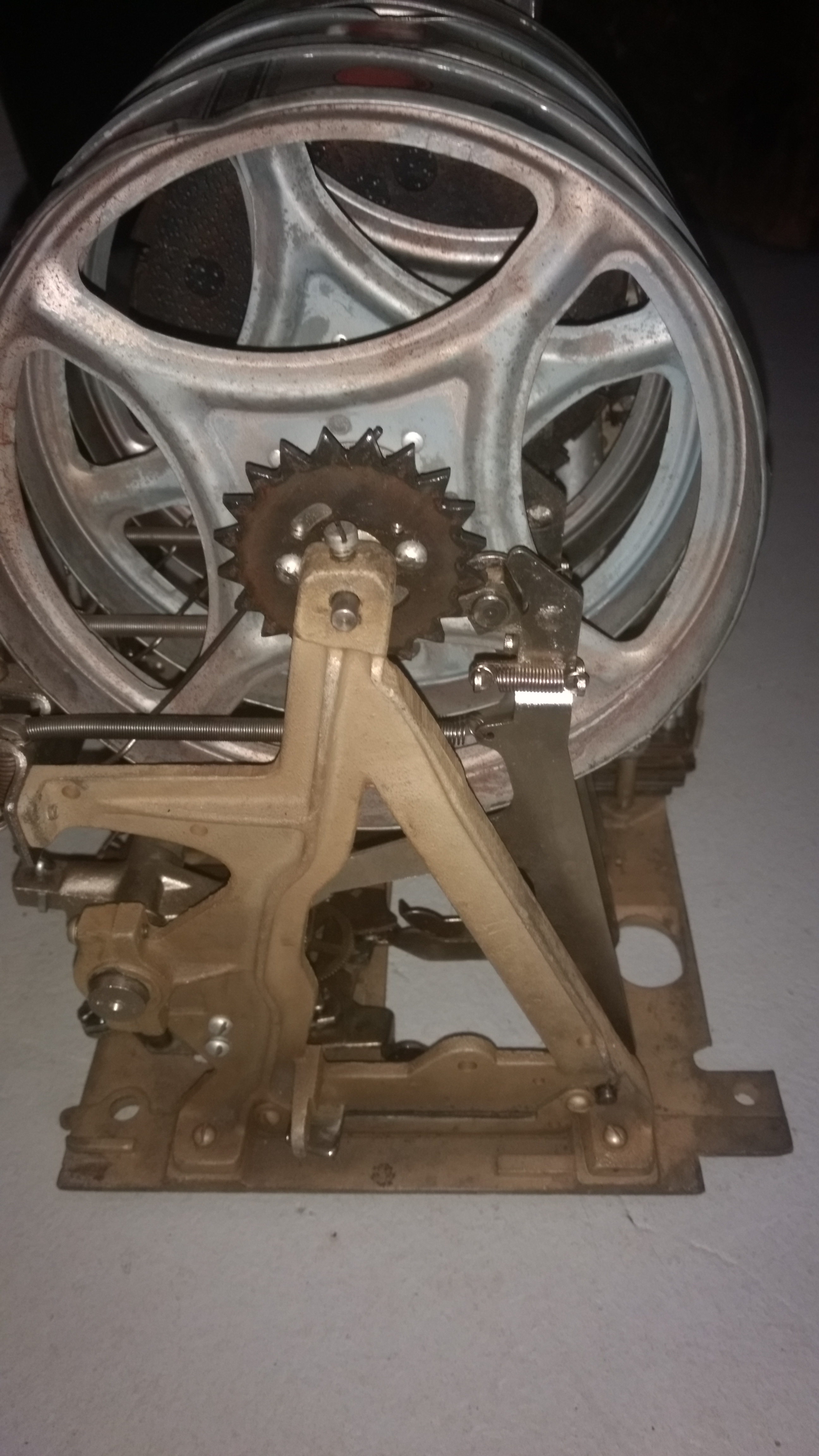

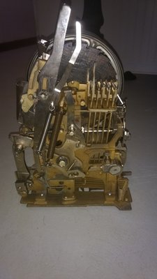

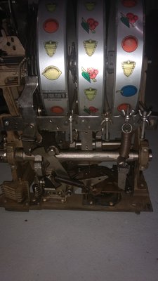

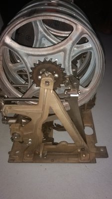

Just wanted to get some feedback on local machine. Does this appear to be authentic or reproduction? Any noticeable miss matching parts or missing parts if authentic. Seller says make offer , mechanism will cycle but reels don't always spin. Any input greatly appreciated. I am thinking it may be a reproduction , but not sure.

Hello; been some debate on whether the castings have ever been reproduced later on. I don't believe so. was super popular at the time & when mills could no longer make the casting in aluminum ,for many reasons, they had another company in Chicago make them for them but, were in cast iron =1944 /1945.
a fast look ; the reel strips are silver "1947" type , should be white. the reel disks them selves have been totally reworked = one can see all the winning holes on disk 1 filled in & no doubt other holes were made for "other wins". fast look = a few minor parts missing. really comes down to the price. in 25 cent play is nice, most common is 5 cent.
how good does the chrome plating look overall ? ; that's the biggest factor.

Postby oldslotman » Sun Jun 25, 2017 7:59 pm
Stripped down mech, wrong handle and wrong award card. Mech looks to new for a machine that old.

Postby SLOT DYNASTY » Mon Jun 26, 2017 1:20 am
As common as this Mills model is, the case may or may not be reproduction. You really have to see it in person to determine.
The mechanism is definitely a Hodge-Podge of original and recast parts, with some common parts missing. The reel discs have
been plugged, and who knows what else has been tampered with. The price is fair, if it were all original, but I would not want
the headaches of making it right. Stay far away, if you can. There are plenty of good original machines to be had. Especially
these HalfTop series of "Diamond", "Black Cherry", and "Golden Falls". It is also best to focus more on a Nickel play, as most of
the reproductions were done in Quarter.

Postby jsin » Mon Jun 26, 2017 2:57 pm
Thank you for all that replied. After reading some articles online and information gathered here , I agree not a good buy ..alot of red flags waving. Now I did see online some good pointers about determining if it's a reproduction machine. But didn't see all that much about the case (casting) itself.. for example the diamond front . How would one determine if it's a original Mills or a reproduction or a recast I think it may be called. I thought I did read some where some diamond fronts that we're authentic and correct era didn't have serial numbers. ( Or am I wrong ? ) So I guess my question would be what to look for on the diamond front case (casting) to determine authentic if no serial number stamped in casting? , Thanks.
jsin
Posts: 31
Joined: Thu Sep 01, 2016 8:45 am
Location: Connecticut
Re: Mills chrome bell / diamond front ( reproduction?? )
Postby SLOT DYNASTY » Mon Jun 26, 2017 6:01 pm
To determine if a machine has reproduction castings, you really have to see it in person, and know what to look for.
Mainly the imperfections on the inside of the castings. No one takes the time to clean all that up. Pictures will not
show you squat, especially if the machine has a new paint-job. The only way to tell on many of the repro castings,
on the outside, is the absence of a serial number. Original numbers usually do not show up in the new castings, and
no one has been in the habit of stamping new numbers in place. At least, not that I know of. Also, many reproduction
models, have brand new cases, that are built slightly under-size, to accommodate the shrinkage of the new recasts.
The people that build these repros, usually do not spend the time to build-up the original castings, to allow for the
shrinkage, or make new patterns.
Another thing you will occasionally see, is a machine with a brand new mechanism. There were some machines that
have been built NEW, from the ground up, because they had the tooling to do so. One example was Royal Bell, out of
Colorado, that was building Brand New "War Eagle" models. They were not trying to pass them off as originals, but
were advertising them as the New "Golden Eagle". The castings were painted all gold, not the typical yellow, black,
and red color scheme. The big problem with some of those now, is that people have repainted them in the original
colors, and are passing them off as original. The Greed never ends. Just as the case with all the Fake "Golden Maggots".
So goes the Latin phrase, "Caveat Emptor".
