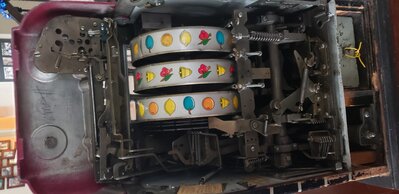

Hello all, I am hoping someone out there can help me out.
I just purchased my first slot machine, I believe it is a Mills High Top Jewel, 1940's. (Pic attached)
Where do I start, I have been scouring this forum just to see how to remove the mechanism. Seems all the pics have 2 sets of levers to lift up before just pulling out the mechanism, but mine only has one set and it sure looks like there are bits attached to the side walls. I sure don't want to screw it up ...
I see there is a service manual by Marshall Fey, I have emailed to order but there is no response... :( This would be of immense help I am sure.
Can anyone show me a video, pics, or something that would explain my machine please"

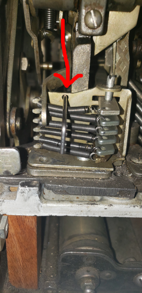

Maybe someone can help with a couple of questions I have while waiting for the new springs to arrive.
1. When in the case and reels are spinning, reel 1 stops normal, reels 2 & 3 sometimes full stop and other times kind of "slush over" and do not seem to make a clean stop. When this happens it doesn't matter what is showing as a combo it pays 2 coins when it should not pay any. Is it a brake adjustment that I need to focus on here?
2. In the picture attached the "rod" seems to be in the way of the spring and is actually touching the spring. I can't seem to see a picture with this "rod" in the books... These springs look out of shape. Any thoughts?
3. There are what looks like a lot of brass colored shaving bits it the machine... What should I be looking for?
