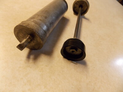

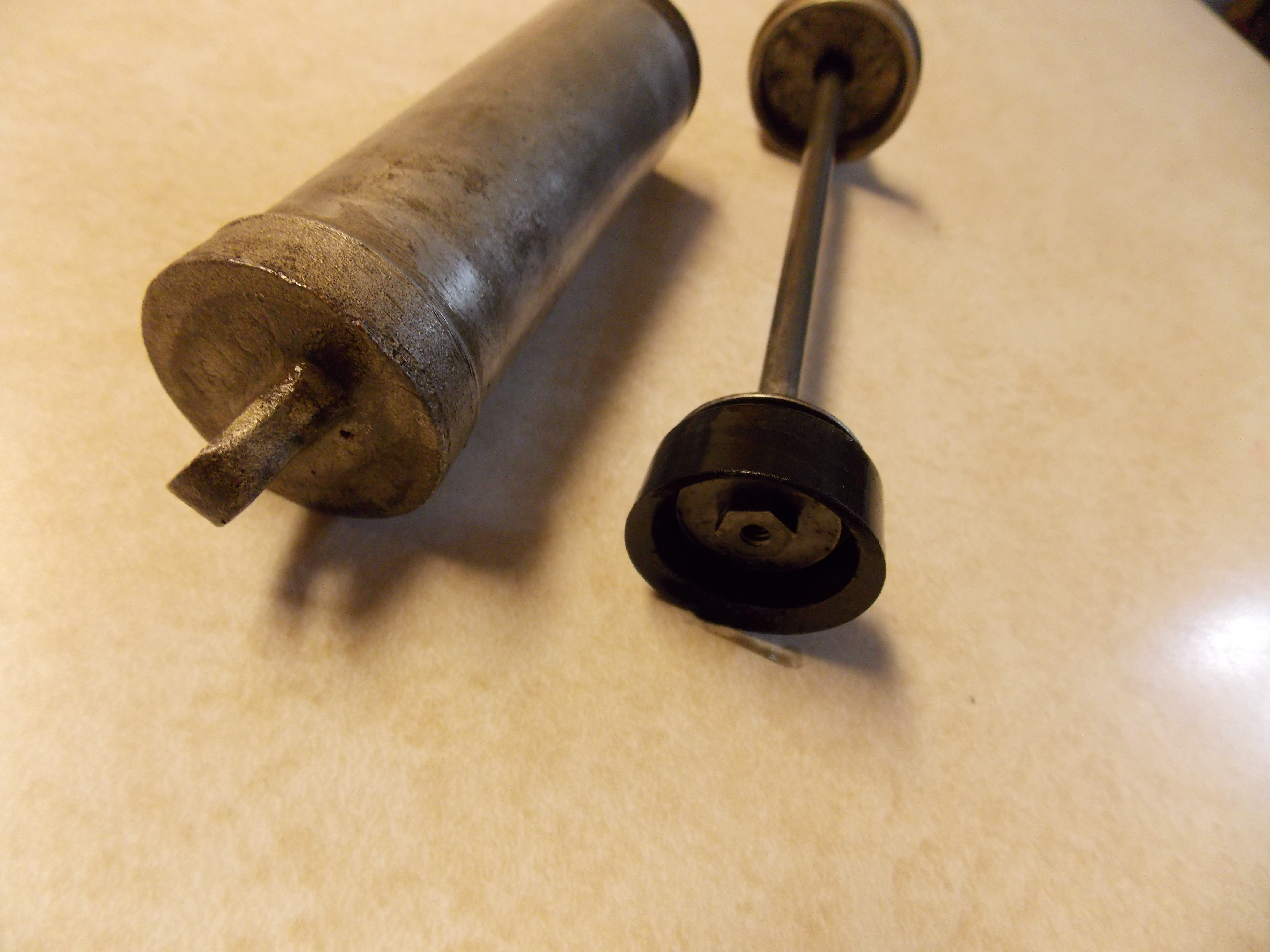

Hi,
I have a 1936 or so Caille Doughboy... Whoever had it before did a terrible job working on it. I have a part that's like a storm door closer, I know that's not the right name for it but someone put a tight black rubber gasket on the inside making the machine difficult for it to cycle. Hopefully I can get a photo for you so you can tell what I'm talking about.
A friend told me on the phone yesterday that originally it was made of leather not rubber.
So my question is what is the correct name of the part and I need pictures to make a new leather gasket like the original. Thank you.

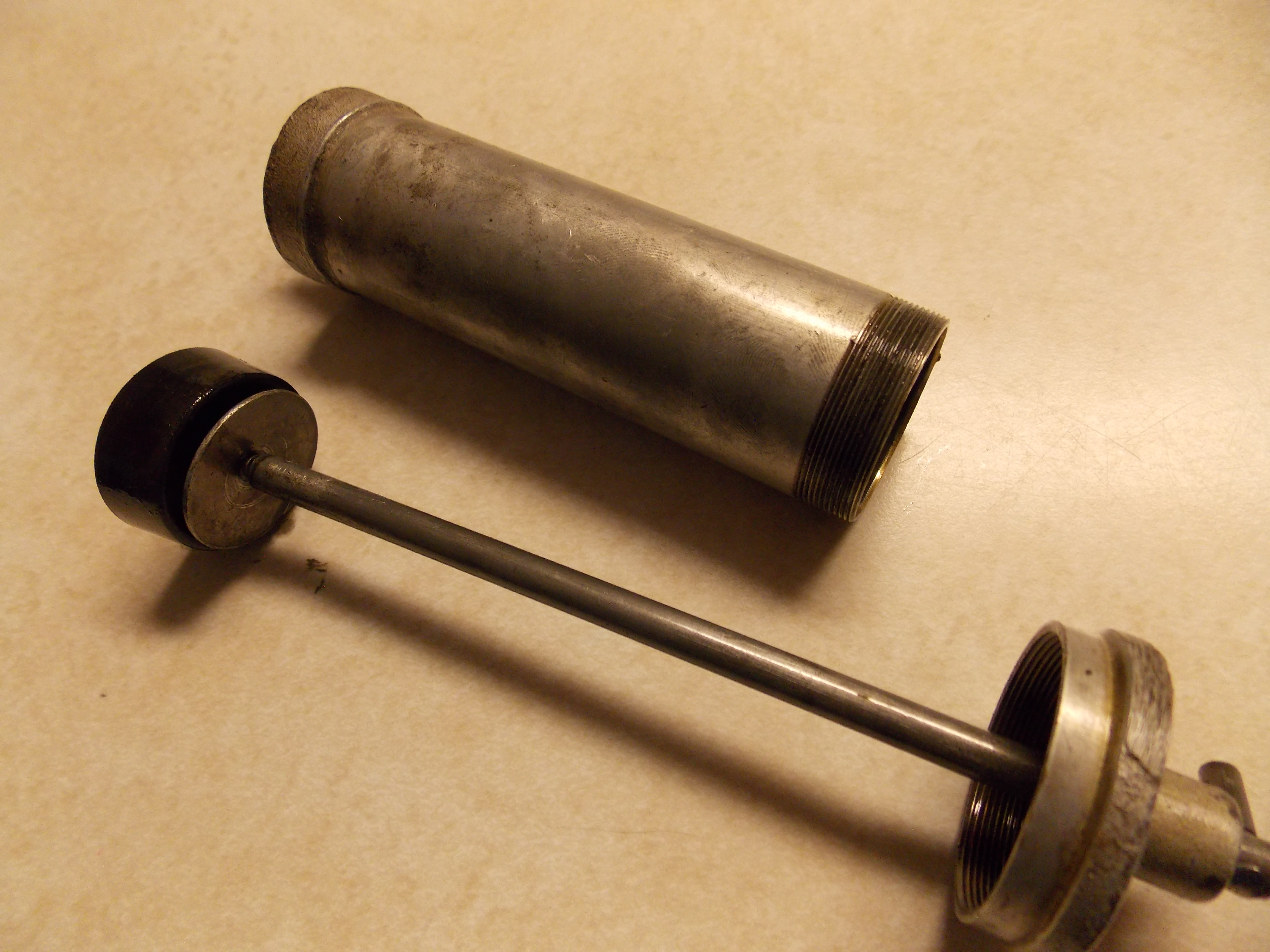

Here's another photo of it.

The rubber is too tight of a fit. If you can find a old foreign car wheel cylinder repair kit the proper size that will work .The leather is more flexible so you have to make one.

Roger Kislingbury has the leather cups for a Caille pump. 626-792-4461. You should soak it in 30 weight oil for a few days before installing. I leave them in a jar of oil until needed.
