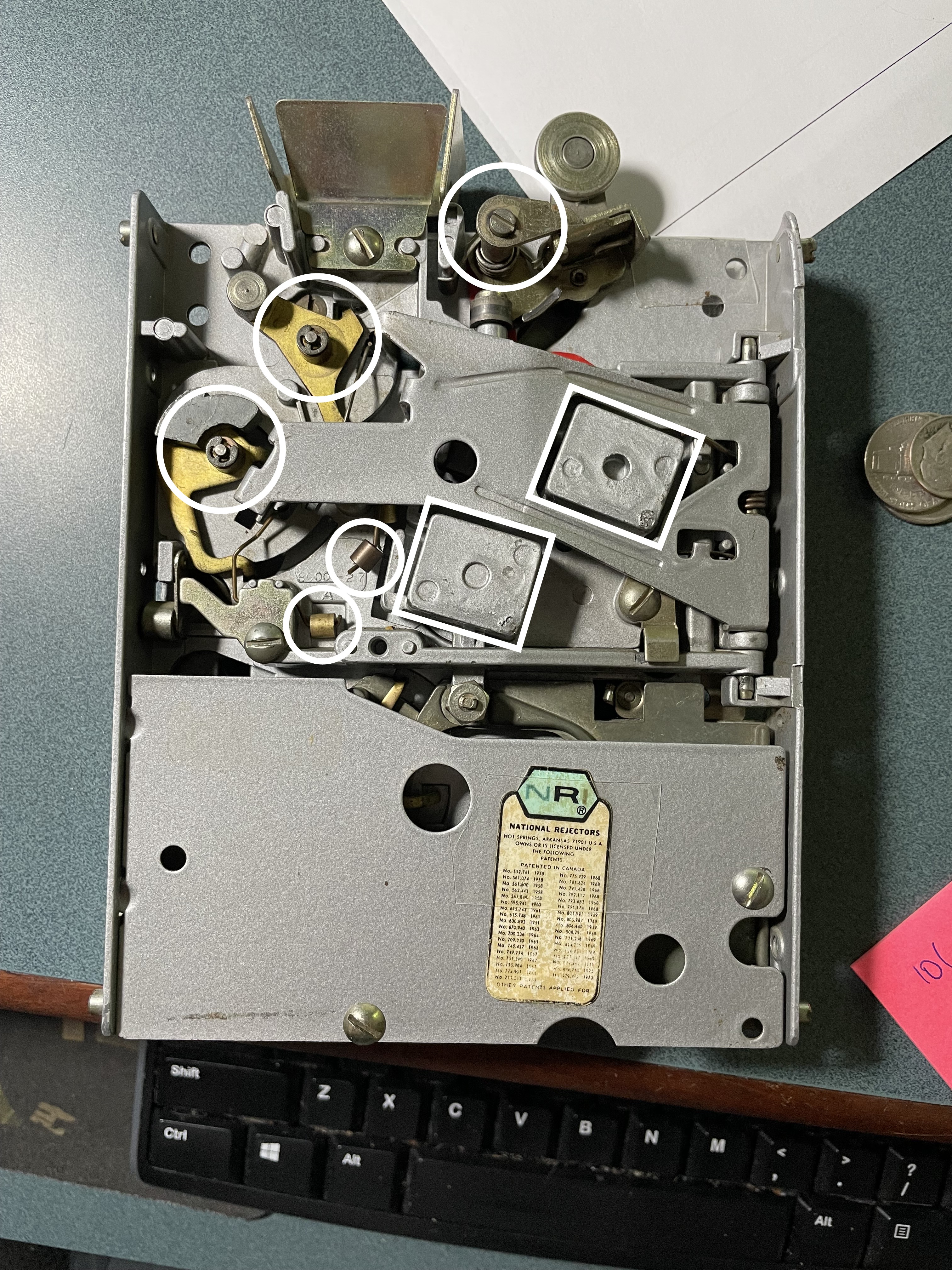

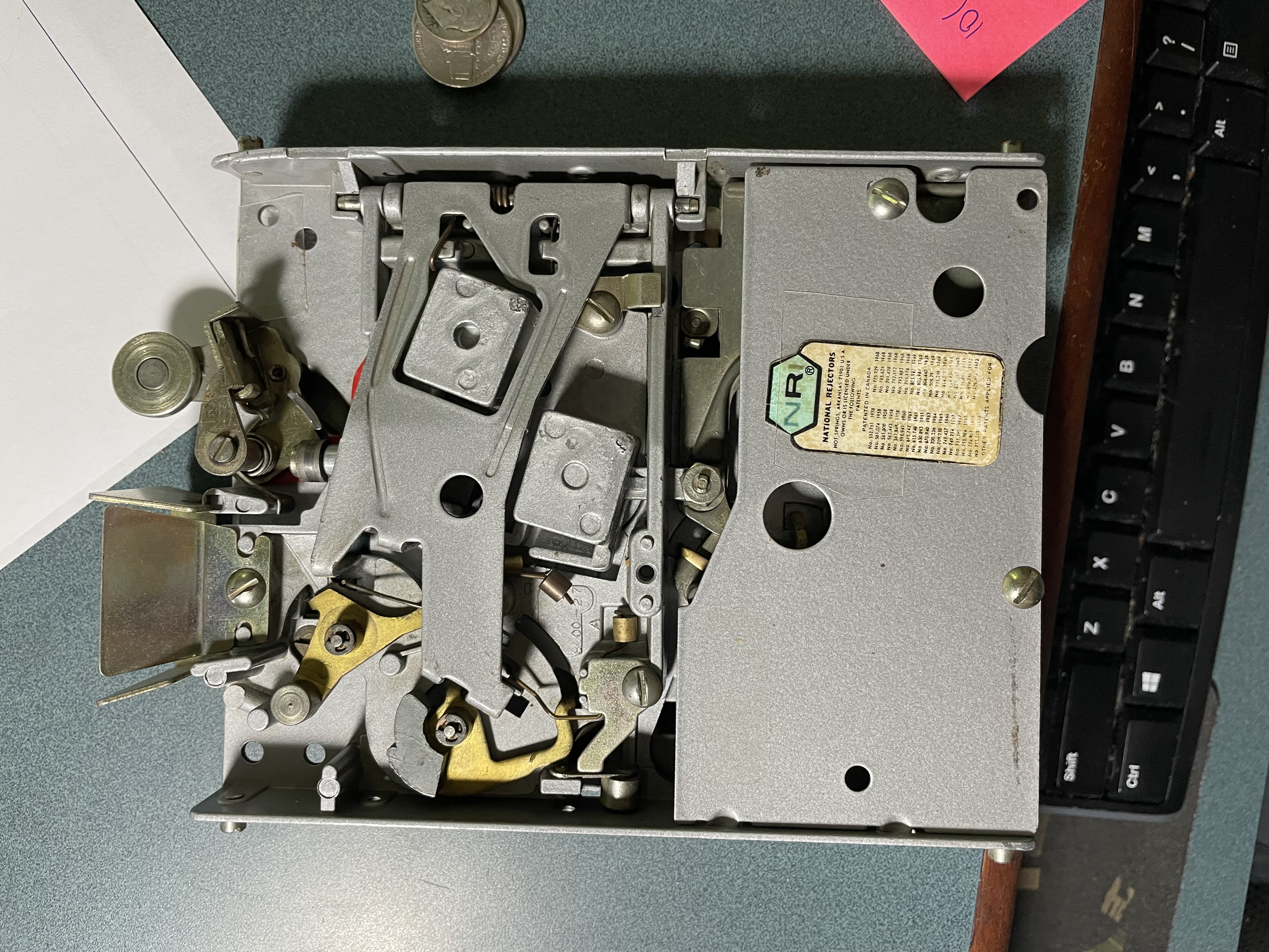

I have a mid-70s Cavalier Coke machine with a National Rejector coin acceptor (see pic).
All coins (nickel, dime, quarter) are going straight to the coin return. I have had the machine for years and the coin mech used to work fine but slowly has slipped to its current state.
If I take the mech out and tilt it back the coins tend to fall in the correct area. When it stands straight up they go to coin reject.
Any help would be appreciated.
Thanks,
Shane

Well while my forte is primarily vintage mechanical and early Electro Mechanical slot machines it looks like what you have there is somewhat, and I repeat somewhat, similar to the coin acceptor used by Bally in the E/M slots and slightly later in early Sircoma and then becoming IGT slots!
This may be redundant as you may have already done this but swinging the acceptor gate open and THOROUGHLY cleaning all the points of contact and interaction with the coin and also cleaning and lightly lubricating all the pivot points in the coin size detection locations as well as the square components which, if like the Bally type coin acceptors are magnetic to catch slugs, Etc. that sometimes pick up residue with heavy use and age that may help as this would also effect the coin thickness testing!
Again, if this is redundant and you have already done this forgive my mentioning it!

Re: Mid-70s Cavalier Coke machine coin acceptor not working
Postby Shane » Sun Jul 04, 2021 11:36 pm
Thanks, Monti.
There was a loose screw that, once tightened, fixed most of the problem. Nickels and dimes work now and quarters are a bit fussy but sometimes work. Maybe a good cleaning will help.
