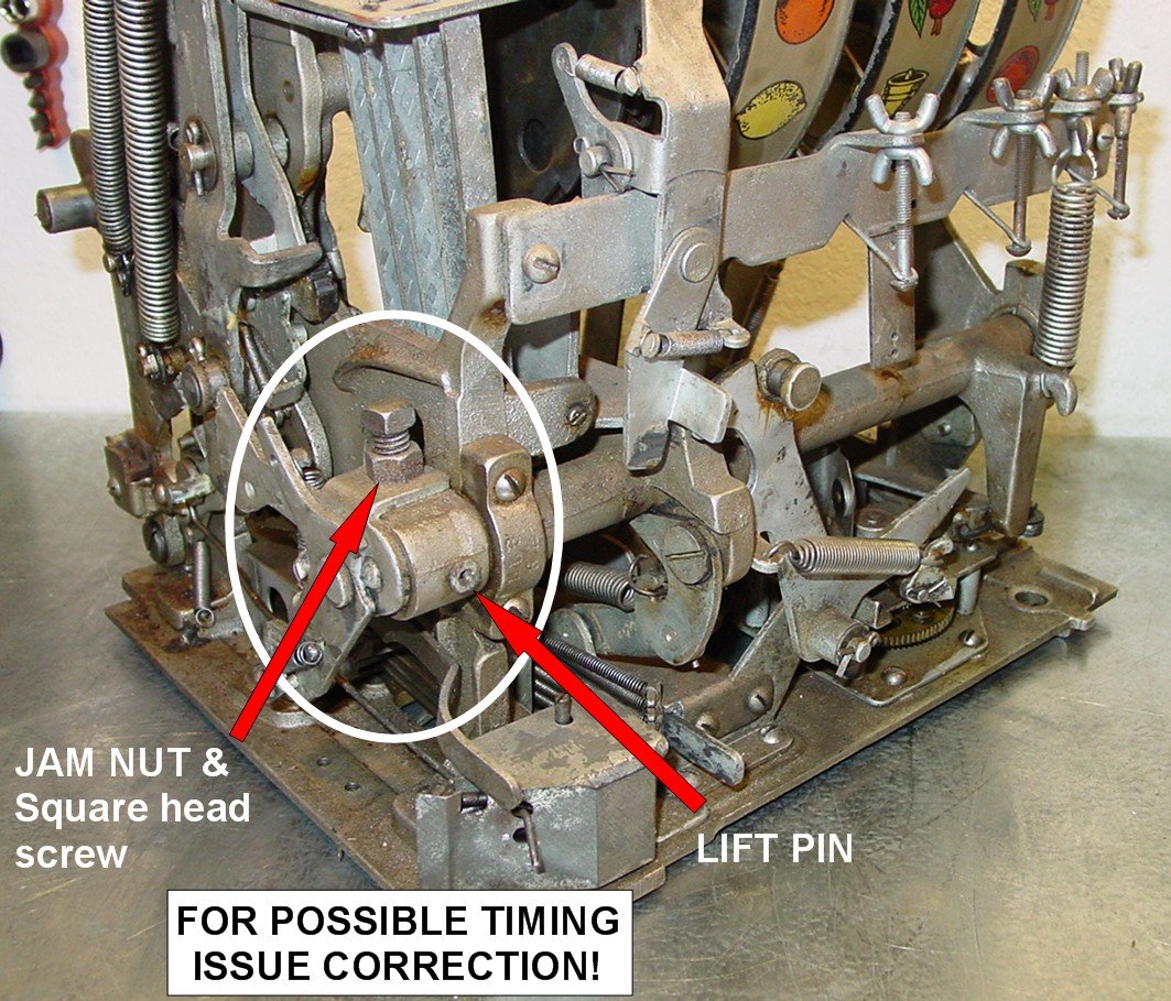

Postby MONTI » Wed Mar 23, 2022 9:19 am
The mech timing could be slightly off as well and also the mech could be in need of cleaning as well as a timing adjustment!
While changing the handle to a casino style handle will help as that is what they did in the casinos so "The Little Old Ladies" playing their bucket of nickles would not stop playing because their right arm got tired or sore but if it has the original from factory handle for value the original handle should be kept on the slot machine to maintain resale value!
Enjoy The Hobby!
Ciao!

Postby Wally » Mon Apr 04, 2022 4:14 pm
Shorting the pin helped. How do you know when the timing is right. Will reducing the tension on the main spring help also. Thanks so very much to ALL.
