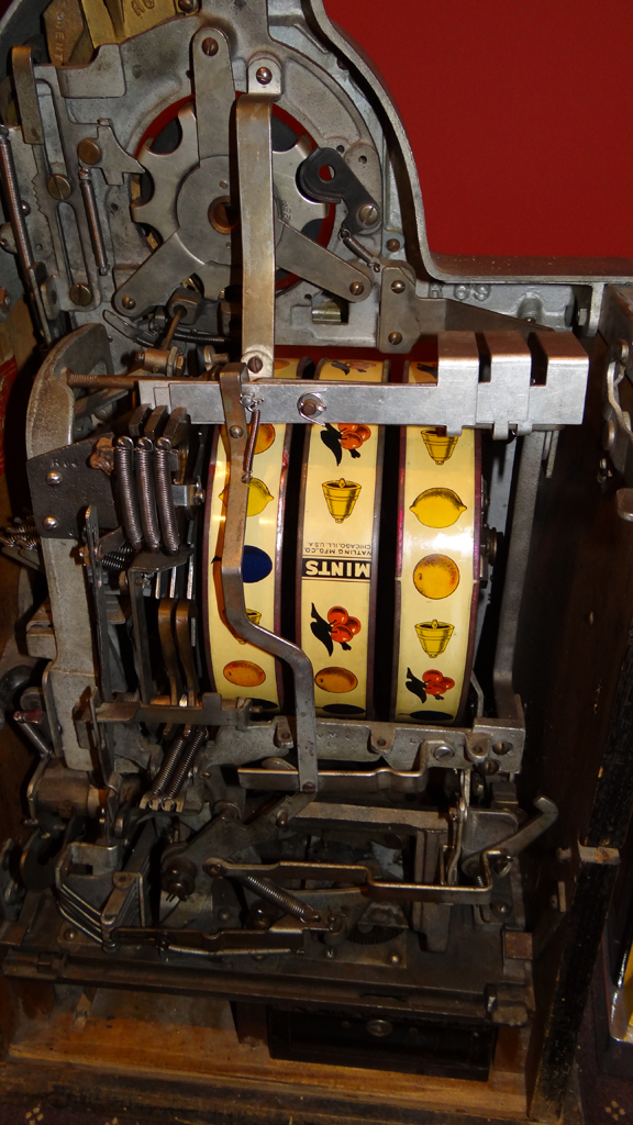

Hi all
I have an early Rol a tor bird that runs on 10c although it was probably a converted french machine as it has the twin vendors, GA and the skill stops.
My question applies to the latter,.

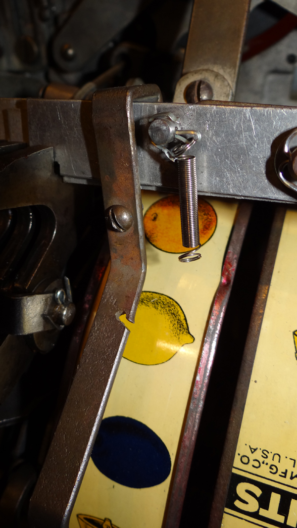

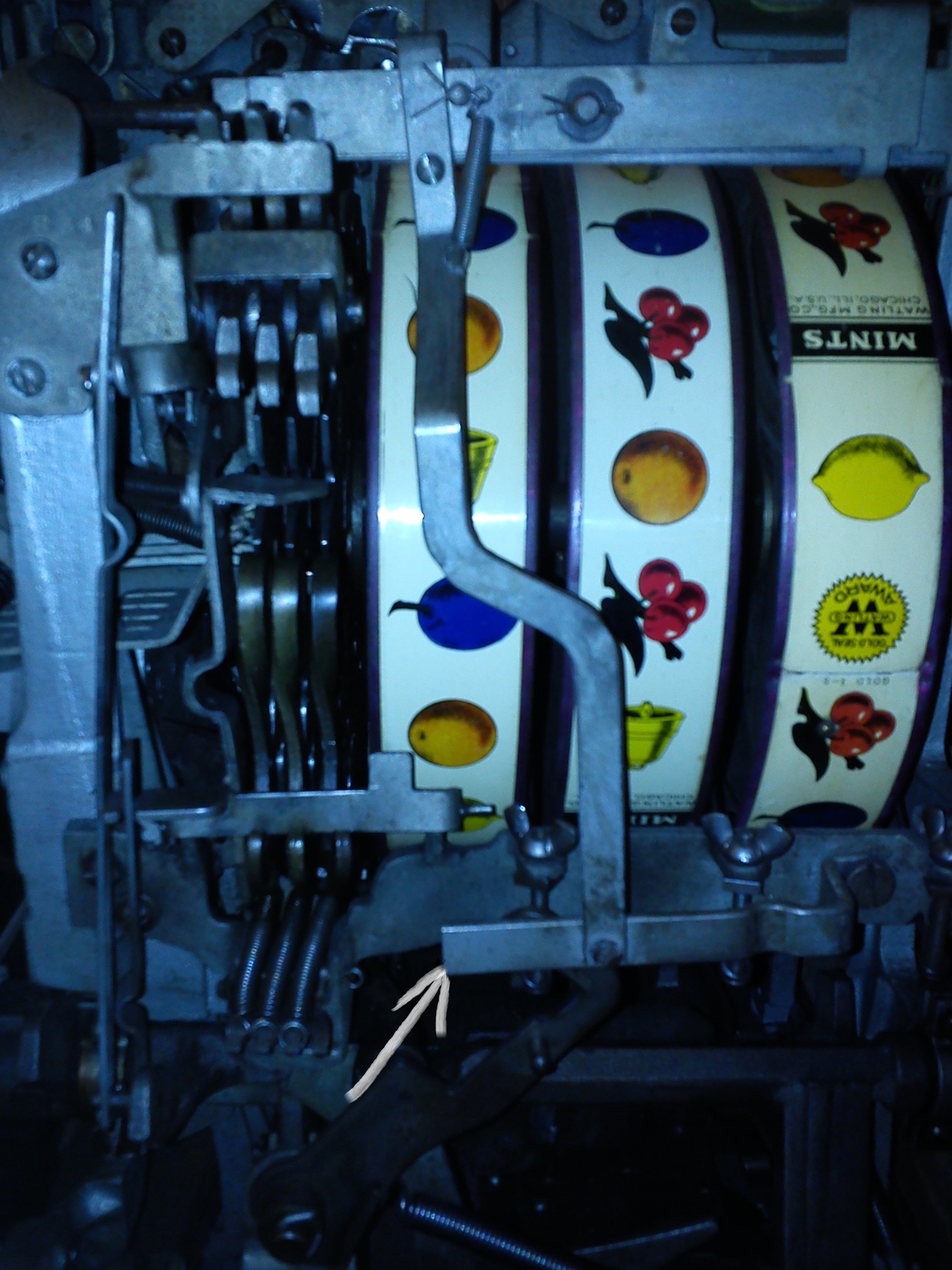

They work fine but i have made them in operable by taking the springs off the indexing arms.
This is because if a winning combination drops in you can hold all three skill stop buttons down and get the payout again on each subsequent game and empty the machine!
If you look at the picture where i have marked the white arrow, it looks as if this bar has been cut as it previously used to engage with something to prevent players from holding down skill stops on a winning combination at the start of each game!
I have searched e bay and all over the internet for pics of the Watling skill stop mechanism and none seem as complete as mine with all i have seen missing this "pull down" linkage?
Could i be in luck as the GA mech and the vendor rod are all there?
Any help appreciated and a pic of a complete RAT skill stop set up would make my day!
Thanks Guys

Your are lucky !
It s the "compulsory skill' system ! And your is complet !no missing parts , all is perfect !
Just remove the spring for active this option , and you will see how this work !
I will try to post some photos ASAP .

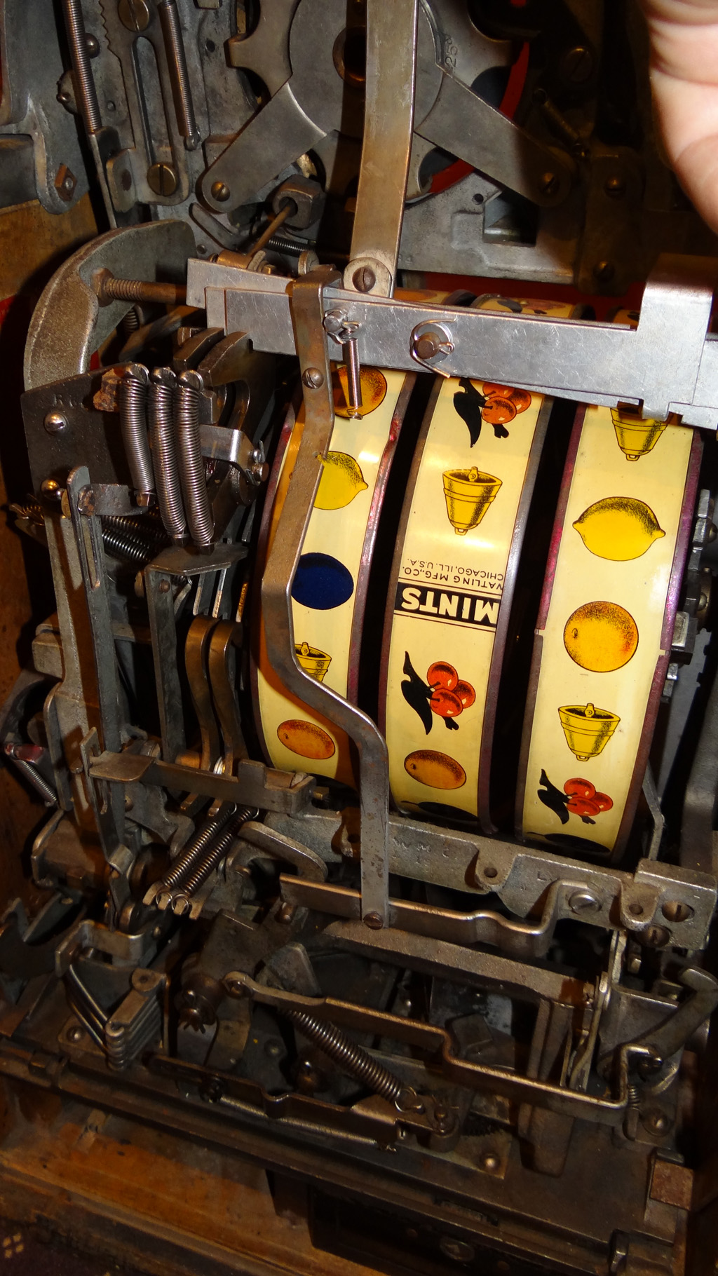

This is a complete Rol a top Mech :

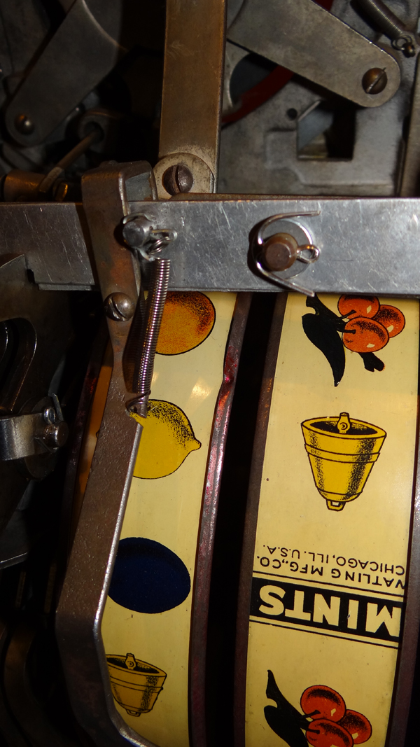

With the spring , no “compulsory skill”:

Remove the spring ,and now you have the option “compulsory skill” and now your slot is open for the law who ask that the slot must to a be a skill game and not a game of chance !

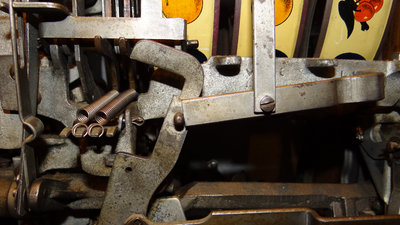

The cycle is stopped after the 3th Clic ! With just this poor little axe !

Just push the skill stop button , and now the mech is free and you can have the 4th and 5th Clic ,and your money because you have it with skill and not via your chance !!

Stephane is great, always very helpful and his English is fine. I'll just add a little more information. The purpose of the skill stops was to change the slot machine from a game of chance to a game of skill, just like the side shooter on a RAT. You can stop the reels in any order, all at once or not at all. That arm that you have the white arrow pointing to is the compulsory feature. This part is almost always gone and I'm guessing most people don't even know it exists. What it does is stop the mechanism before it gets to the fifth click which would be the pay slides going back. The 5th click will not take place until a skill stop button is pushed. This allows the reel stop finger lever to finish its travel and allow the 5th click to happen and allow the machine to pay off. The spring that is attached to that arm puts the compulsory feature in or out of play, in other words, connect or disconnect it. Stephane's pictures show this very well. The part you thought was cut off is the part that hits the pin and holds the lever. When this feature is engaged, the machine could only be played as skill game making sure it was always in compliance with the law. Not sure if this feature was available on other manufacturers machines with skill stops or not. Never seen it on anything but a RAT but others may know more if it was. Normally your machine, if made for the American market, would have fortune telling reel strips but the Rol-A-Tor is the one exception to that rule. How about showing some front shots of your machine. Does it have a 10 cent Rol-A-Tor badge or a replacement badge. Also if you look at the back of the brass coin entry on the mech, it will be stamped with the denomination of the coin entry. It will say 25 cent or 10 cent.

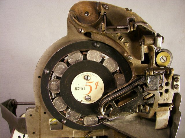

I took a look at the coin entry part you mentioned and you can see from the pic it is stamped "25 CENT".
You can also see it has had a small pieceadded that is silver soldered to take the smaller Dime coin and a dime tube and slides have been added.

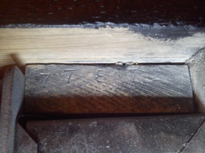

Also notice the serial i found stamped into the right side beside the cashbox.
My question is - what does serial 77872 tell us?
