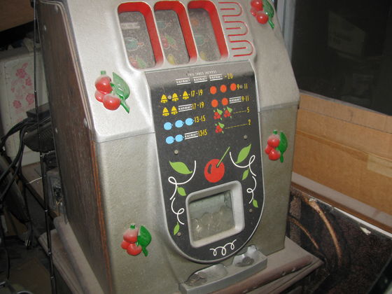

Hello, There are two slot machines available at an upcoming farm auction and i was wondering if you guys could tell me anyting about them. They are a mills war eagle and a mills black cherry. Do you think they are real? What are you opinions. Thanks in advance!

There's a picture of an original one in the link below. Your's looks like it's missing the cherries in the casting above the Jackpot window . . . :roll:
But I'm not an expert, so wait till somebody else chimes in...... :lol:
http://www.coinopcollectorforum.com/vie ... 9f0a975f16

The award card is a reproduction and the reel strips to not look correct.
Black cherry machines should have the sides painted black.
I cannot tell from the photos if the base is original or not.
The same goes for the back door.
Based on the War Eagle, I would avoid this auction.
Go to http://www.IBuyOldSlots.com/ReproArticle.html for information on how to spot the fakes.
