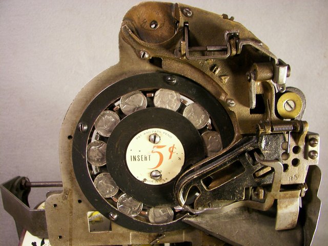

Hi Again
Sorry again about my poor English!! :oops:
I was not sarcastic !Your Denomination badge was made for the late rol a toP ( around 5 years after the ToR !)
This is what you need to have, even I like your “kisses 25ç”
Sorry , I have just a 5ç badge in photo .

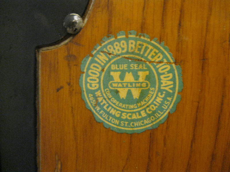

About the silver edging (small silver line between the black paint and wood), it’s this :
And I talk only about the two major trouble on this ToR (promise , I will not say anything about other small default),and I confirm ,it s a very nice original restored rol a ToR and not just a ToR casting add on a ToP Slot machine ! =D>

First of all I think you owe Stephane an apology, although you didn't ask for a critique of you new machine, he was only pointing out that you had the wrong denomination badge on it and putting the correct one on will help your machine. Here's the deal on the badges, yours should have the one that Stephane posted in the picture, he is correct. That is the badge that was used on the early Rol-A-Tor, like yours. There was not a different one for the quarter. Toward the end of the Rol-A-Tor production run, Watling was switching to the blue and white badge. So you could have a late production Rol-A-Tor with a blue and white badge. The brass badge wasn't used until 1938 and the introduction of the removable horn on the top casting. You can easily tell what badge your mech should have by the hole pattern for the screws on the badge. The early white Rol-A-Tor badge has a vertical screw pattern, like yours, the blue and white has a horizontal screw pattern and the brass only has a diagonal screw pattern. I have never seen an exception to this.
The silver on the side of the case. I have never seen the pin routing painted red on a Rol-A-Tor, that I remember, but I have never paid much attention to that. I do know that early cast in horn Rol-A-Tops have that groove painted red, whether it was done on the Rol-A-Tor is unknown until someone can produce a picture of an unrestored one painted red.

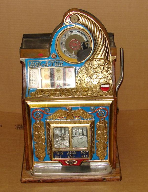

Still no pictures? Is it like this below? Rick B
https://i.ytimg.com/vi/bKPmaaON2rk/maxresdefault.jpg
Why does this Rol O Tor have screws at a different angle?
https://p2.liveauctioneers.com/212/9517/2004004_1_l.jpg

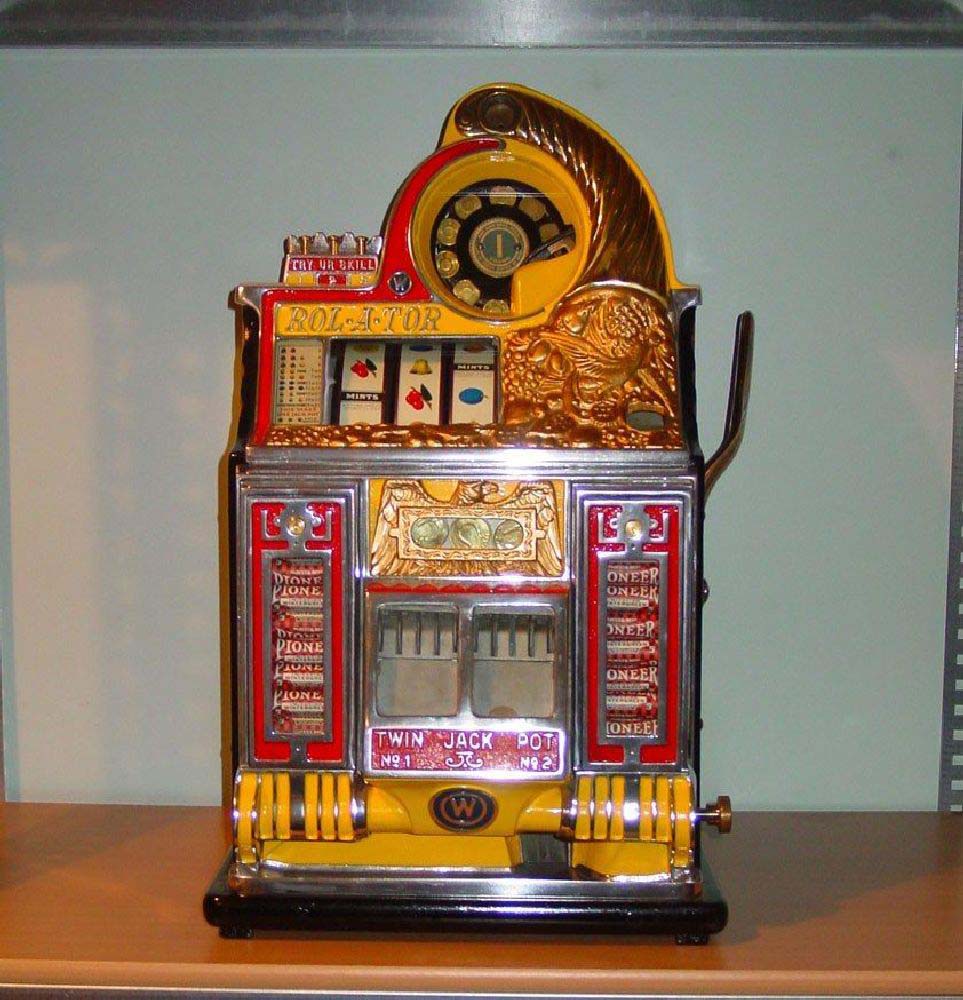

and this one set of screws horizontal?
http://www.pinball-gallery.com/images/g ... 3591-1.jpg
Why does this Rol O Top have the early Blue badge

With the badge and position screw , you can see if it s a correct Mechanism with the correct Casting !
This one have not the good Mechanism ; it s for a Slot after 1938 !
For this second photo , it s an other problem !it s a French Rol a top Bird of paradise made in 1936/37 ,but with a “pseudo” ToR casting ;you have choose the bad example !
Look Here :
viewtopic.php?t=4596
For find a good info , never look a restored slot machine ,but original untouched !

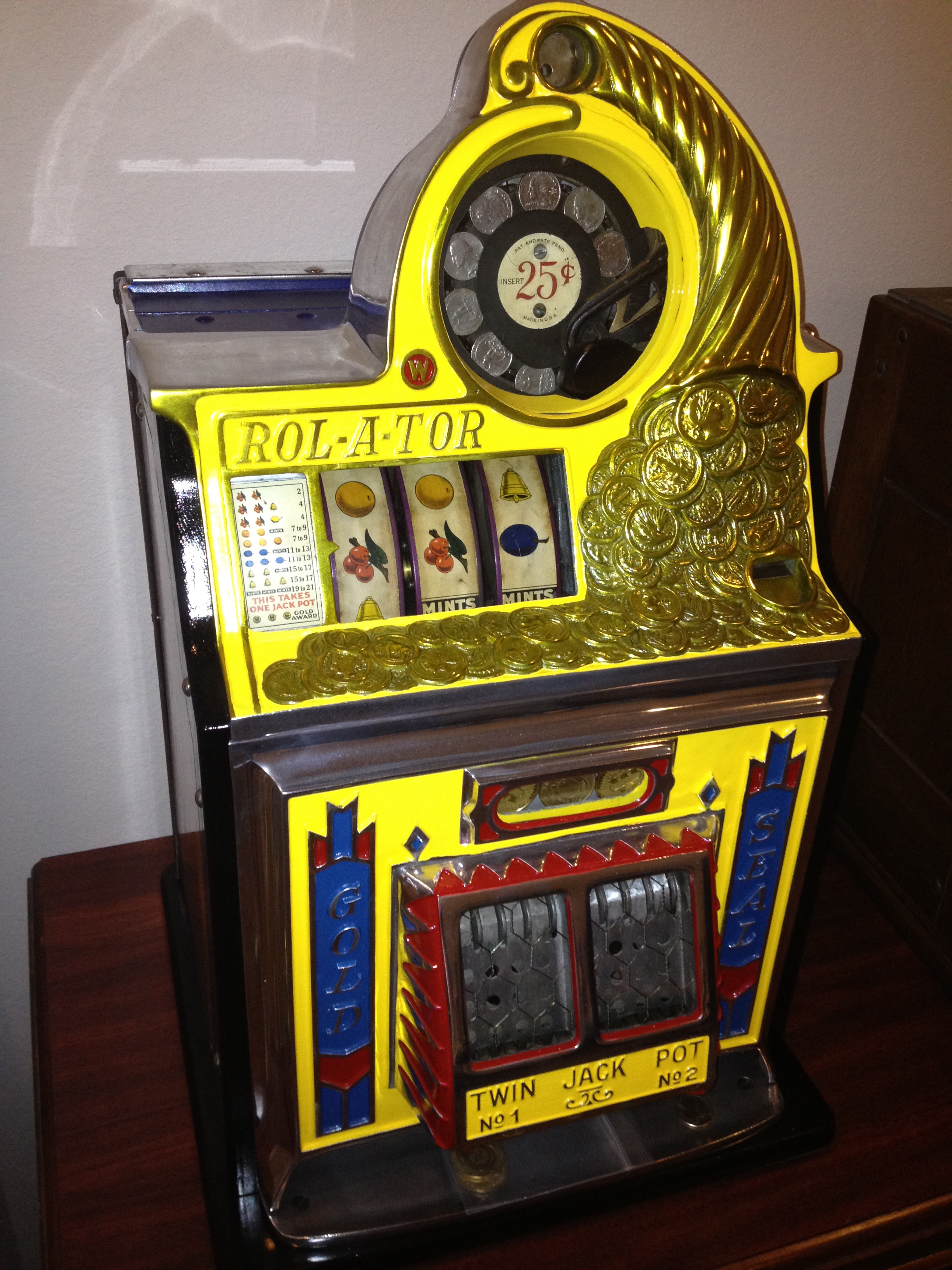

Here is a $.25 Rol-A-Tor. The machine was found a few years ago in Indiana hidden in a wall. The family was selling the house and the estate seller notice a loose wall board. When the board was removed there were two machines. The family had lived in the house for over 50 years and did not know they were there.
The house was in Indiana and the estate seller wanted nothing to do with the machines. They contacted a picker who bought them. He then contacted me and I bought this machine. The other was a Mills Bursting Cherry.
Someone had spray painted the entire machine so the castings needed to be stripped and re-painted. I didn't have time to do it so I had the machine shipped to Jeff Frahm do does high quality Watling restorations. Getting those coins painted and using a the tinted lacquer is difficult and Jeff is one of the few guys in the country who know how to do it correctly.
The mechanism just needed to be cleaned.
The only reason I am posting this is because someone wanted to see a $.25 Rol-A-Tor with the white badge.
This is actually a pretty uncommon Rol-A-Tor. The bottom casting says Gold Seal. It is not a modified Blue Seal machine
I don't know why everyone is getting so bent out of shape over this. I sure wouldn't make a decision to buy or not buy a Rol-A-Tor based on the badge. Of course, most people would prefer a pristine untouched original machine. But as we know, those are hard to come by.

You can't take examples of machines that are cobbled up and poorly restored to prove a point. I'm sure you don't hold up a rife that has been modified or screwed with to prove a point of authenticity. Unrestored original machines are your proof not the stuff you have posted. However, they do prove my point. The first machine has the wrong mech in it as Stephane mentioned, Watling never put fortune telling reel strips on a coin front but impossible to prove, right? That being said, early mech with blue and white badge, horizontal screw pattern, correct. Second machine, What a mess that is, wrong mech again, that mech has gold award on the reels with a solid coin front front casting. Again, brass badge with the hole pattern correct for the brass badge . 3rd machine, French Rol-A-Tor Bird. As I mentioned it was correct to have a late Rol-A-Tor with the blue and white badge. Again the horizontal screw pattern is correct for the badge. The last picture was too small to enlarge but if it is a Rol-A-Tor with a brass badge it is wrong and I'm sure if you contacted Don Creekmore, who is Nations Attic, he would tell you the same thing. I have attached 3 photos of unrestored, untouched original machines to show you the difference but I don't think it will mean much to you. You seem to already know plenty and have it all figured out. This post ends the pissing contest, I won't be responding to you again. Good luck with future collecting. Just tried to upload the 3 photos and a notice appeared that said the "Board attachment quota had been reached." If Dave can fix that, I will post the pictures.
