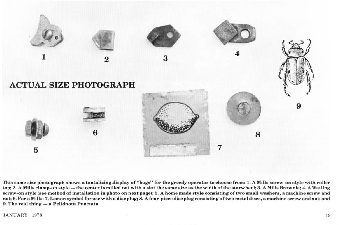

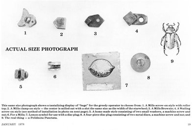

About BUG ,here is a photo that everybody know( I think ) ! Come from the excellent "Loose change " magazine !!

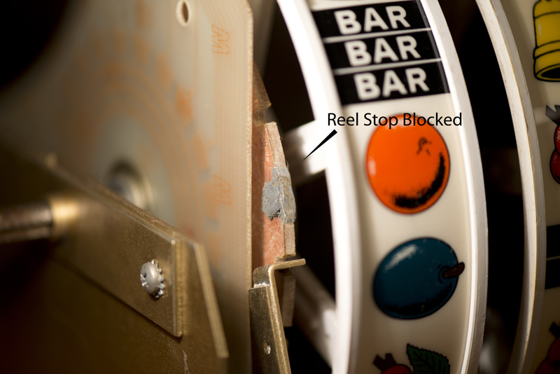

I took several Jennings electronics J400's apart (all from the same casino) and found several bugs on the high pay slot. The stop wheel was made of fiber board and the filler used looked like automotive body filler:
