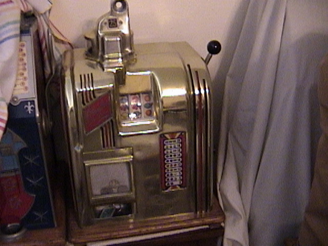

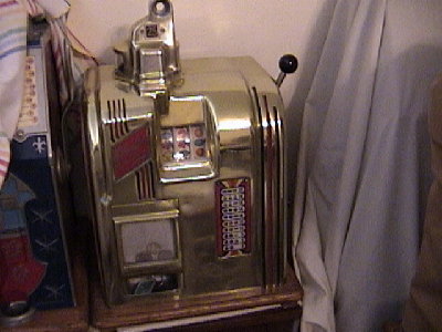

I thought this Unusual Grotchen might be of interest in the US. In this format its quite rare. made with a single jackpot, taking a UK 6d coin, and with the European 'numbers' reels rather than the usual 'fruits'. 1946 I think. The jackpot is still auto fill but without the swinging arm needed for the double jackpot version.

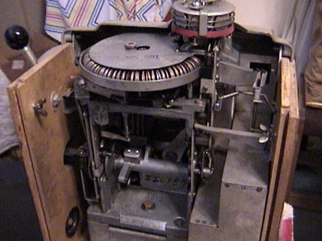

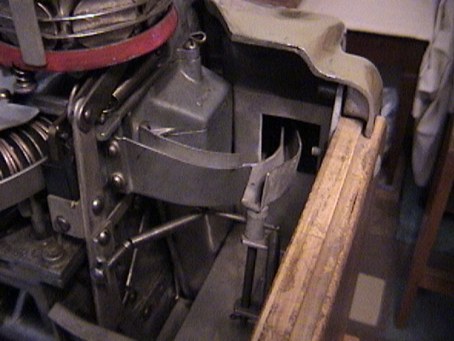

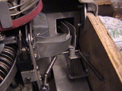

no ,I didnt get the coin change set :( I'm also missing the jackpot fill slide, its a simple thing I believe and I want to make one, could you post a photo of the slide on your machine so I can make one? really would help,thanks

Postby TJ » Fri Apr 29, 2011 10:36 am
I hope these are clear enough. T.J.

Postby coppinpr » Fri Apr 29, 2011 12:14 pm
thanks for the photos,very helpful, looks like they used the standard double jackpot fill with all the conections except the arm that mae it swing from one to the other
thanks again
