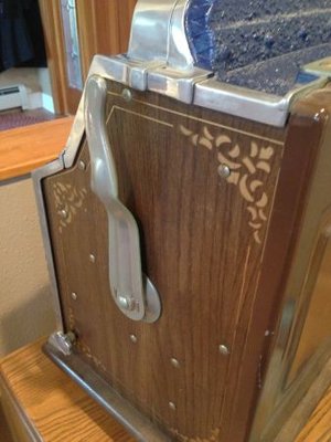

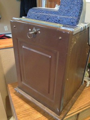

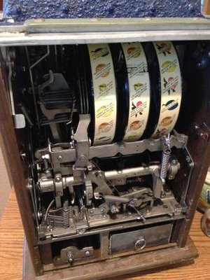

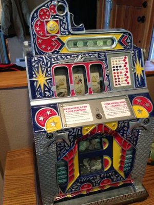

Hi Everyone,
I wanted to get anyone's input on a machine that I am thinking about buying. I have a couple of attachments listed. I have spent a lot of time reading Dave's forums on reproductions and wanted to know if this Mills is Real or not. This will be my first purchase of an Antique slot machine and hope to be a avid collector of these beautiful machines. Also what is a fair price for the machine and any other info that might help...thanks to everyone for your input.

The machine is not painted the correct colors. The wood appears to be refinished which is OK for a restored machine.
Other than that it looks OK to me.

Nice first slot! besides the castings not painted properly the only other thing I can see is no brake wires. As far how much it's worth , ck to make sure it pays and plays properly, the mint vendor works properly, the F.O.K.'s had linkage that went from the right mint vendor up to the escalator that would reject the coin if the vendor was out of mints, check the castings for any repairs or damage, some times they paint over areas that should not be painted to hide repairs or damage, look over the mech to see if it looks like any parts have been removed and left out.

This machine has never been reproduced. It is way too much trouble because of the vender. The hucksters want easy machines to do. I've never heard of it referred to as a Modern front, I believe Mills called it a Silent FOk, also heard it called a Mills Peacock Front. This was part of the Mills Silent line made in the mid and late 30's, i.e. War Eagle, Roman Head, Castle Front. The Silent FOK was one of if not the most expensive machine in the series. The back door is 1/2" taller on this machine and is unique to this machine and I think the Extrodinaire vender front. Looks to be a nice machine and the mech appears to retain it's original cad plating. When it left the factory, it did have a lock out for the coin if the vender was empty, most all slots with venders had this because if the vender was empty, it was an illegal machine if run in a city or county where only slots which would vend candy or gum were legal. This machien has a simple adjustment to overide this. I wouldn't base whether I bought this machine or not on whether that lock out was still present as they were often removed completely.

Back-tracking to the FOK though, two posts have said the castings are the wrong colour.
What's the correct (if such a difinitive scheme exists on any machine?).
Comparing with the photo in Slot Machines On Parade, it's bang-on plus with the item in question even the relief patternation in the casting shows the aluminium.

The FOK seems to be pretty correct with the colors and placement of colors to me. I once had an original FOK and it sure looks the same. Dave, I thought the Skyscrapers were color coded from Mills factory, BLUE fronts were nickel play ,RED fronts were dime play. At least that's what I've seen over the last 36 years of seeing and owning original Skyscrapers. I guess it really doesn't matter sometimes what the color is now, as long as the owner likes it and it's been painted with care.---Pete. (P.S., that blue Mills skyscraper "2 for 1" in Al's background was mine up until yesterday.)
