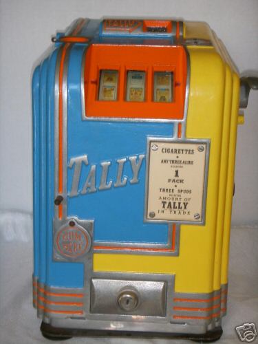

Postby SLOT DYNASTY » Mon Aug 26, 2013 11:48 pm
wdjs:
Before you start on this project of repainting your "Tally", you will have to take into consideration, that the Tally was produced in more than one color scheme.
At least six color-combo original variations that I have seen, plus three single-color versions. The most common of the multi-color examples, is Blue & Tan with Orange.
My favorite is the Blue & Yellow with Orange. The one pictured on page 145, (lower right), of Dick Bueschel's Trade Stimulator book, is one that I restored several
years ago, and all photo's of it are on 35mm. This was long before digital photo's were the norm. The machine was sold long ago, and was again resold on eBay, in
July 2006. I do have a pix or two of it from the eBay sale in a file, which I will look for, and post. So, it all boils down to what your preference is. If you want to stay
with an original color scheme, you will have to see several variations to pick from. There may be one or two still in the eBay 'completed items' listings, but you have
to be aware that it may be an Incorrect Repaint. The two I have in my collection at this time, are not restored. One has faded original colors, and the other is a
single color version.
I found the pix.

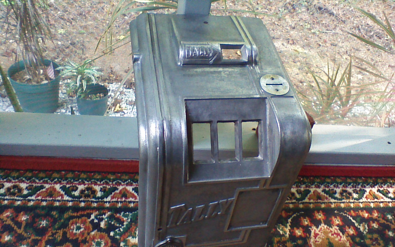

Postby wdjs » Tue Aug 27, 2013 1:51 pm
Did daval make a tally without a gum view hole or is this thing a repro.

Postby nvmos2 » Tue Aug 27, 2013 5:42 pm
wdjs;
The tally did not have a gum view hole;
just the gum filler chute on back door and dispenser hole on front (with a flap cover).
Bill;
I have Tally number 5559;
it is the common blue and tan with orange color.
I think the paint may be original, but it looks too good; may have been repainted.
On mine, the small cash box door on front is painted blue.
In the photo you posted, the cash box door is unpainted.
Which is correct? Painted or unpainted or both?
This may give a clue whether mine has original paint or not.
Thanks,
Jim

Postby SLOT DYNASTY » Tue Aug 27, 2013 9:40 pm
Thank you for bringing this feature to my attention. Yes, the Tally came in two variations. One version had a small circular gumball view window at the
top left of the casting, and one did not. Yours does not have this window. Daval had a habit of making very suttle changes in some of their models, but
why they did something like this is beyond me, as all models had the same gumball mechainism. This dinky view window is rather silly, all you can see
in it is one or two balls if the compartment is full to the top. After that, you would need a flashlight to see anything. You'd see more by just looking in
the loading door on the back. They also made another change to a casting on some.
Rest assured, that you have an original machine. Nobody has ever repoed the Tally. There would be no reason, as it is a very common machine, which
is in the affordable price range. The only parts that I, or anyone else has recast for this machine, is the small coin door on the lower front, and gum-exit
swing-door, which are sometimes missing. I have also reprinted the strips & card for this machine. The cigarette symbols seem to be the most popular in
this model, judging from my sales. I would also like to get the serial number from your machine, for my History Update Files. I do not have many serials
for the Tally without the view window, and would like to see if yours fits into the same time-frame as the others. The serial will be stamped on the back
edge of the lower casting, just below the door. It could also be stamped on the underside, in which you would have to turn the swivel plate to see it.
Hopefully your machine is complete, and your restoration turns out well. By the way, what repaint colors were on your machine when you purchased it?

Re: daval tally
Postby SLOT DYNASTY » Tue Aug 27, 2013 10:11 pm
Wow! I didn't even see your last post, before I wrote the above. You have already answered a couple of my questions. Thanks for the serial.
Regarding the painting of the lower front coin door, this is another variation. Some were, and some were not. Mine was not painted, which
I really prefer better. Reason being, if the door is opened a lot, over time, the paint is bound to get it's share of chips. But usually not the
case, if it is in a collection, and doesn't get handled much. So, this is your choice. If you want total originality, then paint it. Also, I have
seen a couple of machines with the gumball exit swing-door painted. That is NOT correct. Just the letters, and circle are orange, like on
mine above.
One other thing I forgot to ask. To go along with the serial, I need to know which reel strips you have, and if the coin entry plate says:
"One Cent", "Five Cents", or "Coin Here". Thanks
