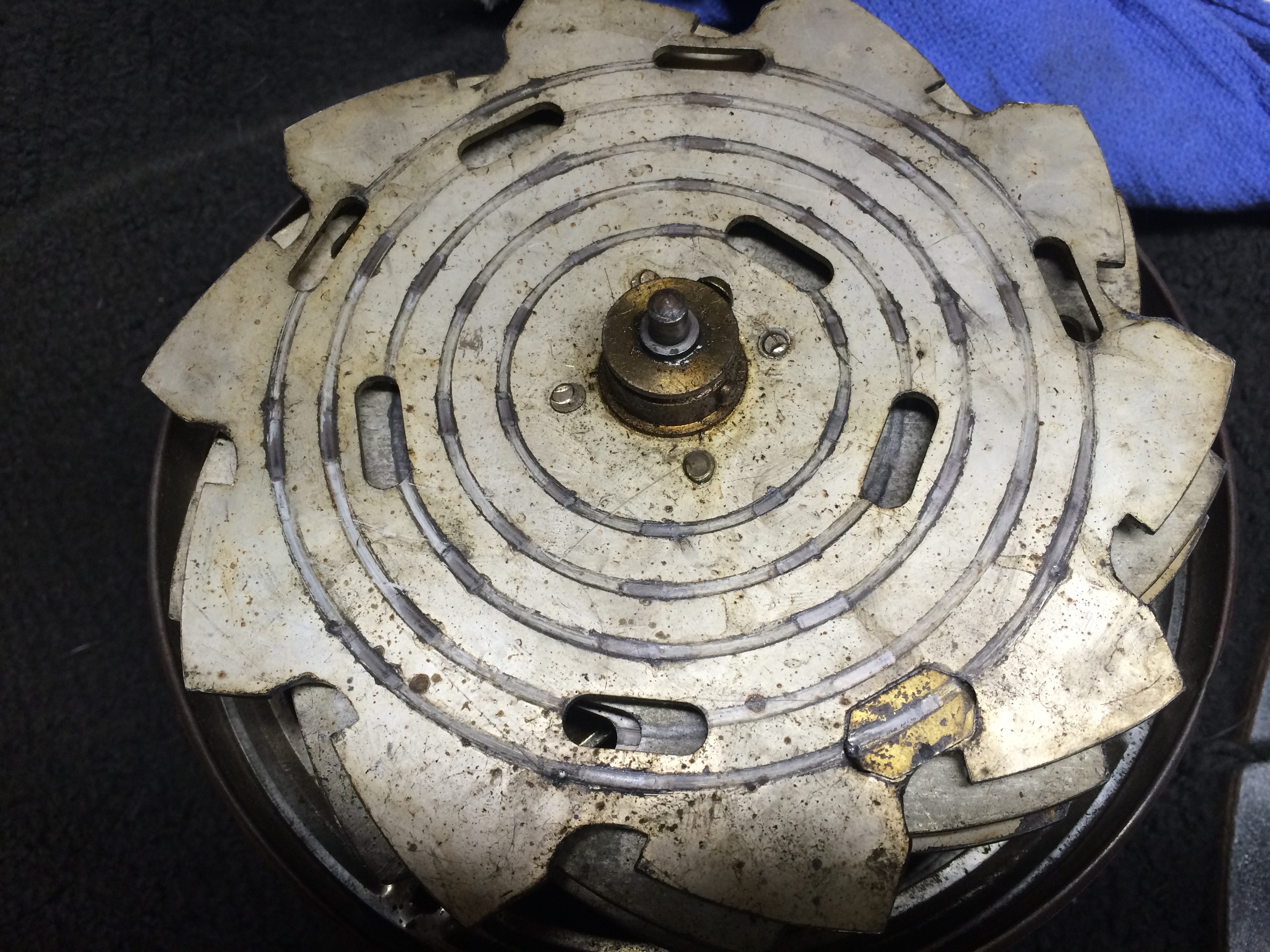

Postby damikeguy » Mon Apr 06, 2015 4:05 pm
I found my first bug. A Watling 5 cent fancy front. They blocked one of the cherry's on the first reel. What surprised me was they didn't cover the cherry with a sticker.

Postby TheFatman » Mon Apr 06, 2015 7:14 pm
As far as I know ... the bugs I have found ... seen ... are the ones that allow thae machine to have the correct symbols in position. What the bug did was to allow the index disc or reel disk, to slide over the bug and go to the next symbol. What I feel you have found, is a machine that either had a different reel strip on it. But probably, one that was blocked for the symbol and a lemon put in its place that has since been removed. Do a search for slot machine honest abe and you will see what the most common of bugs look like. Thats what a certain style bug was called ... ironic aint it?

Postby damikeguy » Tue Apr 07, 2015 2:16 pm
Thanks TheFatman,
I need to check the rest of the reel bundle and look for more like it. The thing is it has the original metal reel strips?? Next time I have time to play and not work I will check it out and get back with you. Im going to be busy this weekend at the Chicago Coin OP Show. Need to look for another project machine or two, some parts and hopefully a nice treasury or Lion Head.
