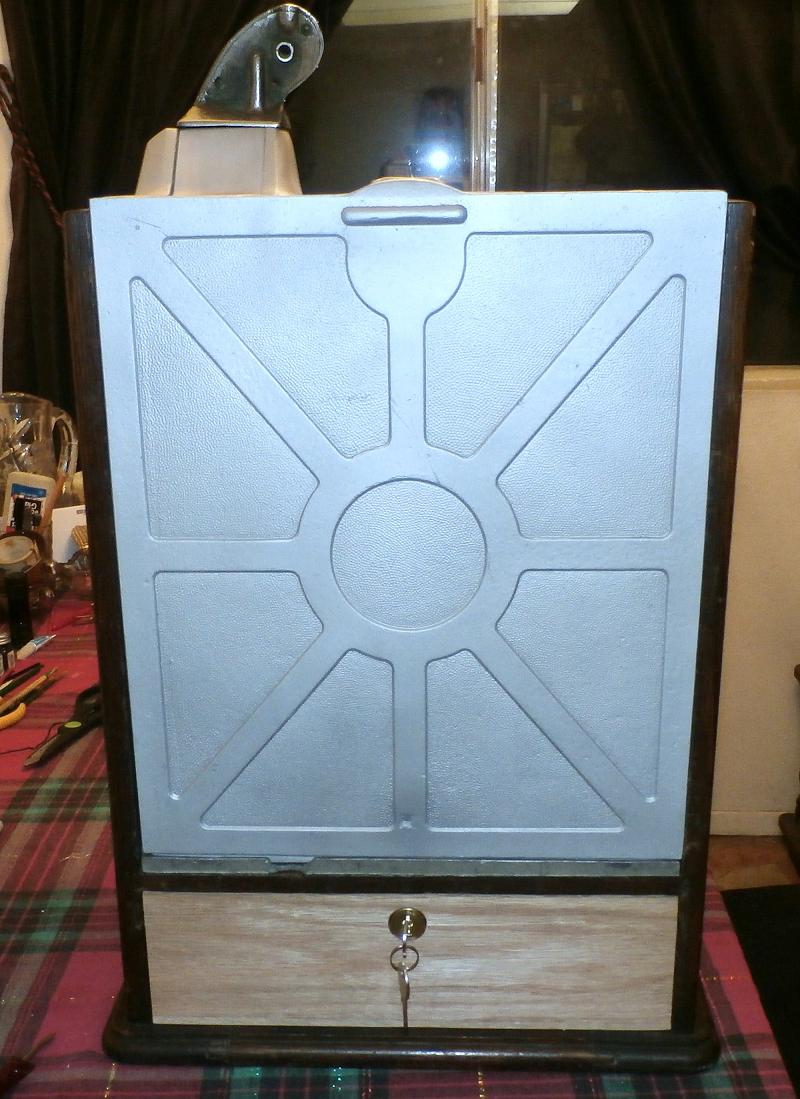

Hello to all;

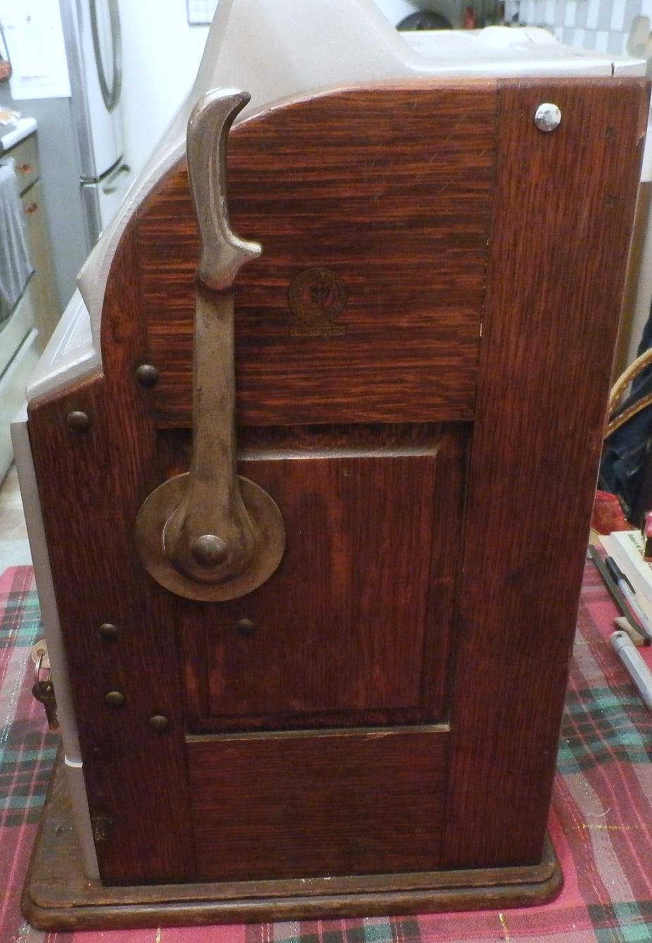

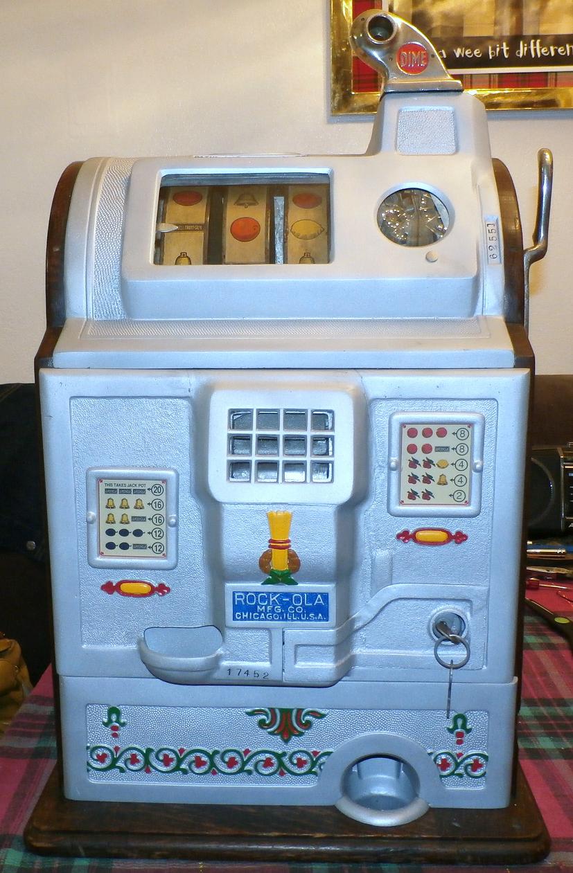

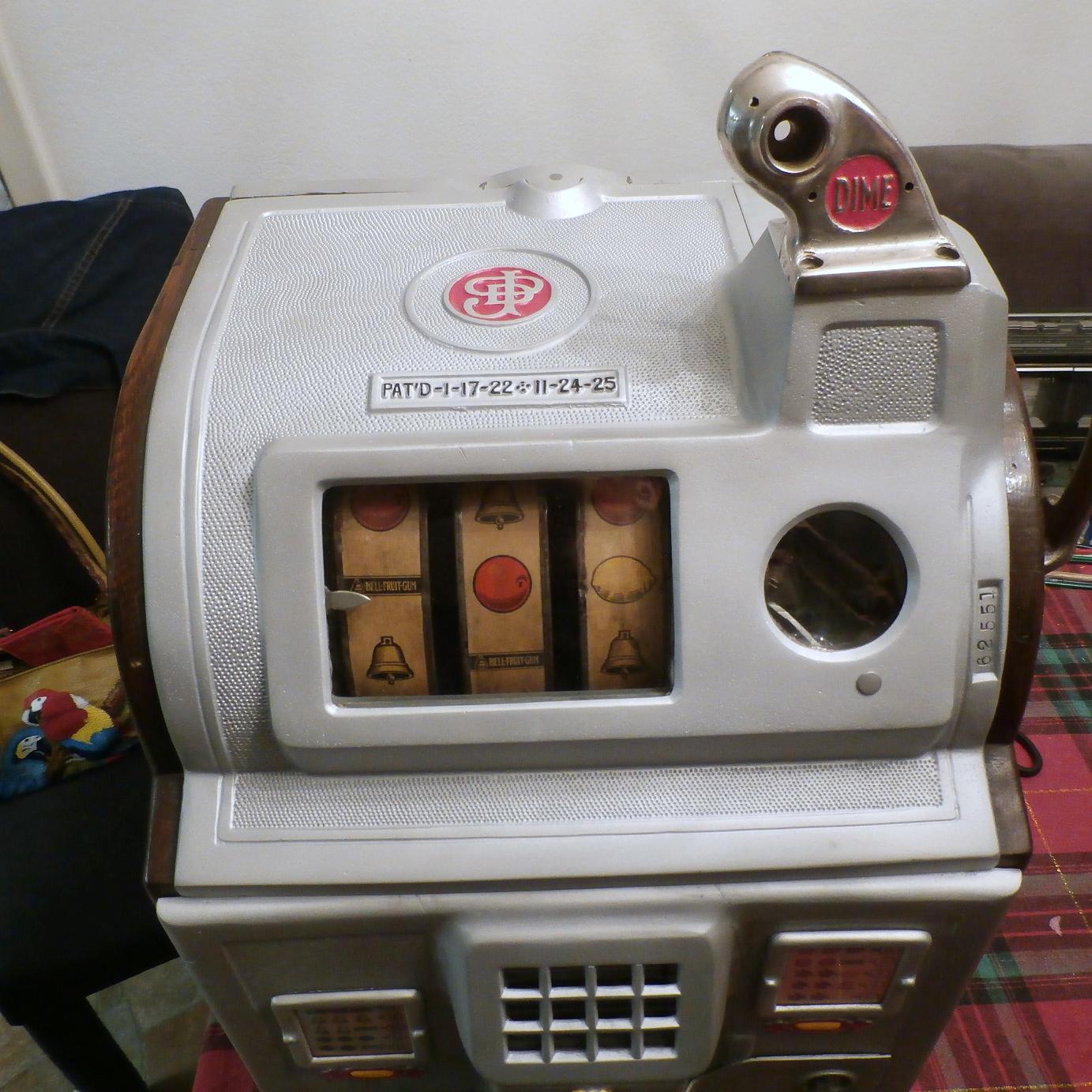

A few photos of my "1925" Jennings / Rock-Ola revamp. Not completely done but ,getting there.
since no lower back door ,I made one out of Oak (not stained yet). reel strips are original & will not replace. P.O. cards had to be replaced, no choice. had several layers of silver paint on it. sand blasted it all off the out side , then matte clear coat. didn't blast the inside , not needed. hand painted the little stuff.
front door is a reproduction also.
Mechanics need some tweaking . has the Jennings ser # ,& also the Rock-Ola ser # still on it. thanks for looking ! Jeff H.

Re: Jennings / Rock-Ola revamp.
Postby oldslotman » Sun Jan 15, 2017 8:37 am
I wonder how a piece of Buffed Aluminum Formica would look on that lower door.
Postby saloonkpr » Sun Jan 15, 2017 8:58 am
Why Not Just buy a RePro Door ??
saloonkpr
Posts: 100
Postby oldslotman » Sun Jan 15, 2017 9:38 am
Getting hard to find and I don't think anyone is making them anymore. I believe there are about 3 or 4 different sizes. Maybe some out there, you just have to find them.
Postby Richard13 » Sun Jan 15, 2017 9:45 am
Jeff maybe some silver duct tape over the oak would look good and be in budget? Lol kidding but when I get back I might see how much a piece of billet aluminum is and mill one or two lower doors just to see what they would look like. Don't know when that will be and the weather sucks here in Illinois. Wish I could be back in the desert.
Richard13
Posts: 321
Location: Tempe Arizona
Postby briank » Sun Jan 15, 2017 10:26 am
Richard ...just wait,freezing rain tonight and into the morning but mid 50s by Tuesday. Welcome back to Illinois!
briank
Posts: 238
Location: Leland, Il
Postby JHSS-1944 » Sun Jan 15, 2017 9:02 pm
I did talk to a few parts dealers = no lower doors, original or fake.
Plus all the hoopla over older reproductions that were made wrong (shrinkage) that still pop up on e-ban , ect. for sale. really don't want one that has big gaps at the top & sides.
Plus I had seen some photos of an "original " one made of Oak.
I had 2 just in reach to buy, then the sellers changed their minds. "need to keep ,just in case (I find a machine 50 years from now that needs it).
I do what I can......
And oldslotman is correct; the originals ,depending on the era of the machine do measure out differently. I made this one = "1925", smaller than the one I made at the same time for my 1936 Jennings.

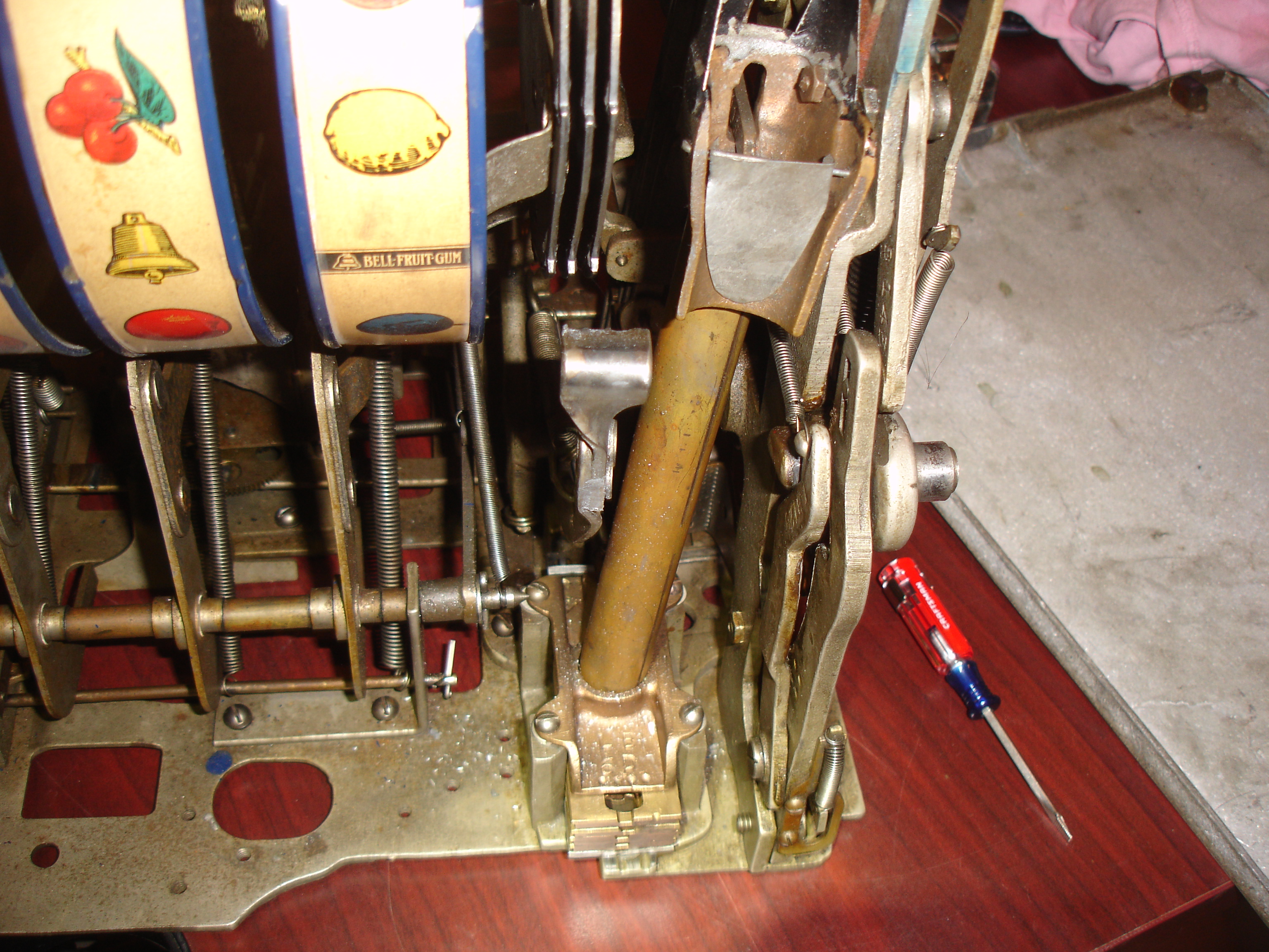

Postby JHSS-1944 » Tue Feb 14, 2017 1:24 am

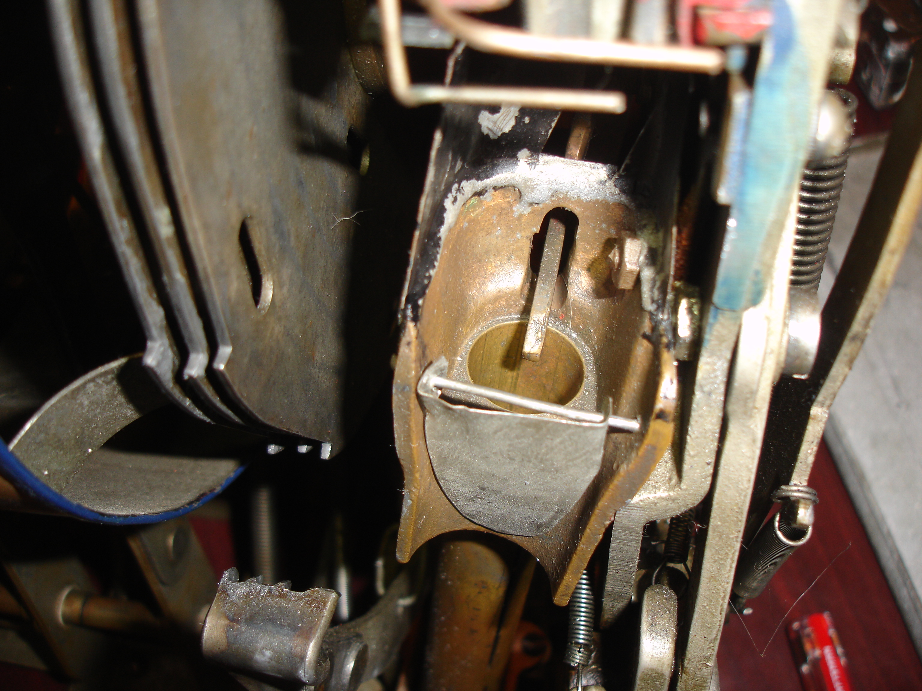

o.k. lets see if I can get help on this one.
this machine is question; the coin tube was home made, old but , looked terrible. so recently bought a dime coin tube but, for a sun chief. of course it doesn't fit.
Any one want to share any photos of the correct coin tube ? not sure if originally was the Jennings still used , or modified since the machine has the J.P. added , or a new one altogether by Rock-Ola.
Really don't want to cut this original Jennings one up to make it fit, specially since the top part is just junk pot metal & a "hard to find part". So the plan is to just make another one as close as possible. just need some photos for the shape ,size, total length, ect.
I believe the top part was a bit lower than most would be & think it was held the mechanics by a bracket , not directly screwed into the frame ??
fear another machine I should not have bought.

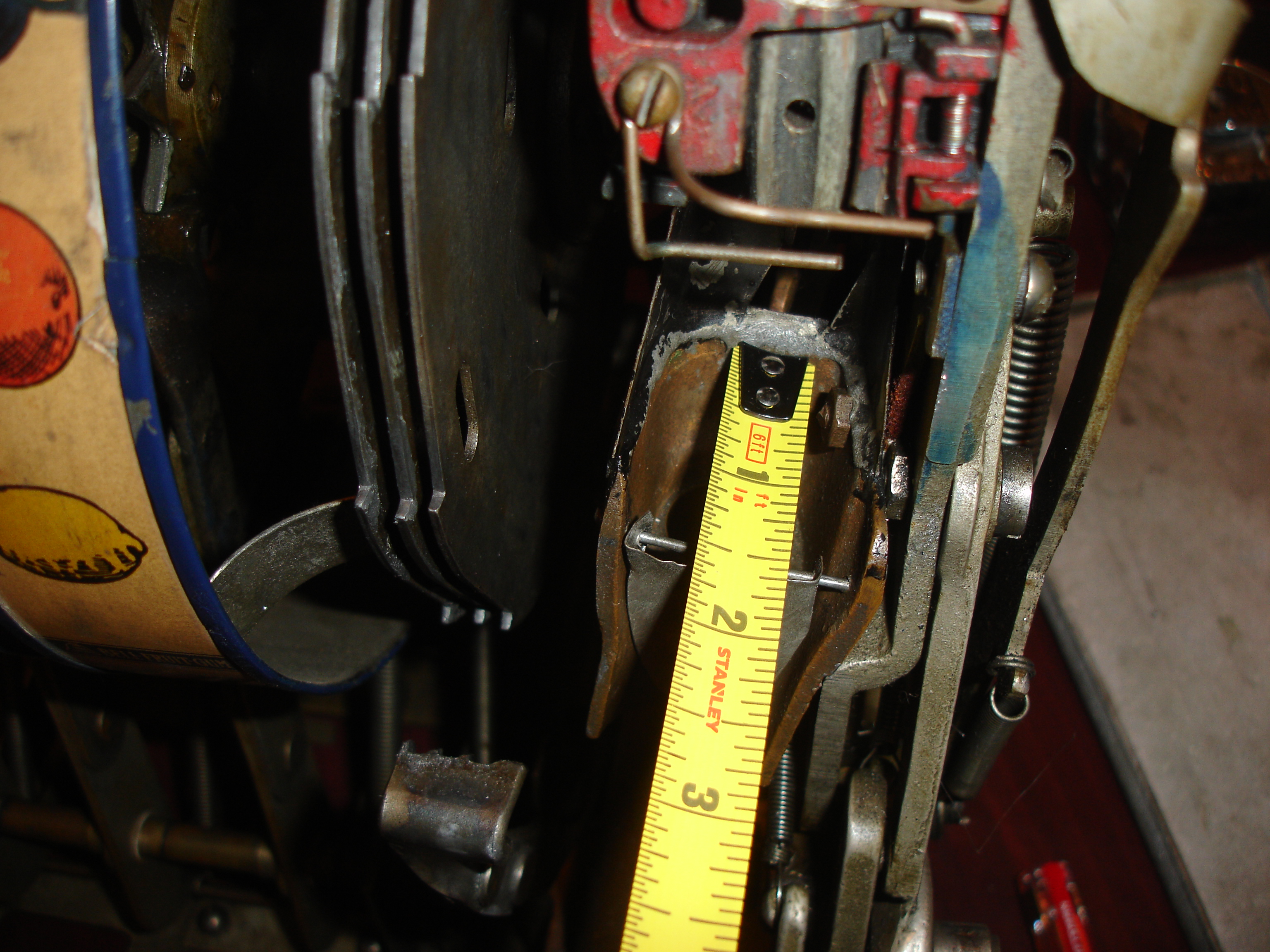

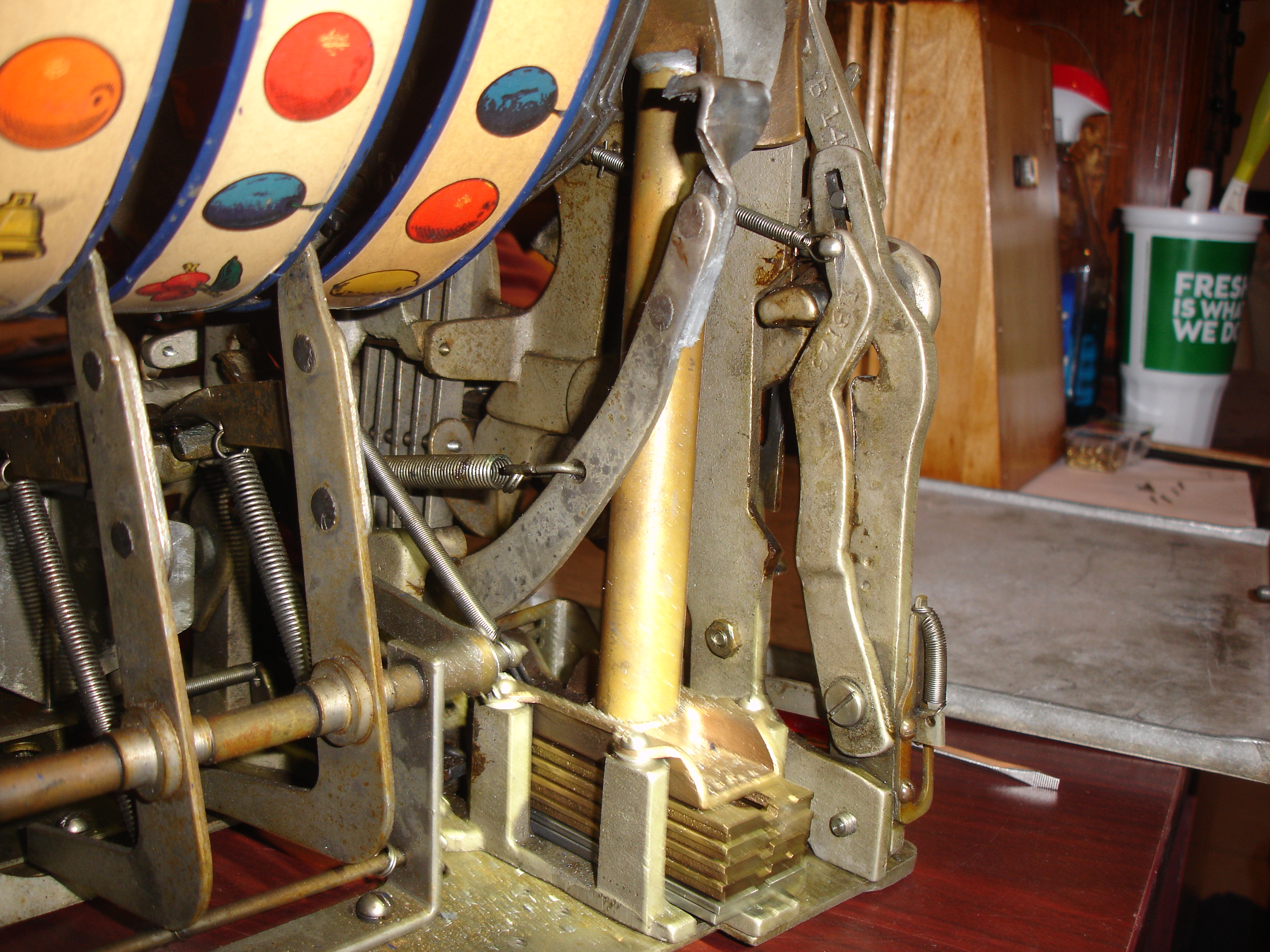

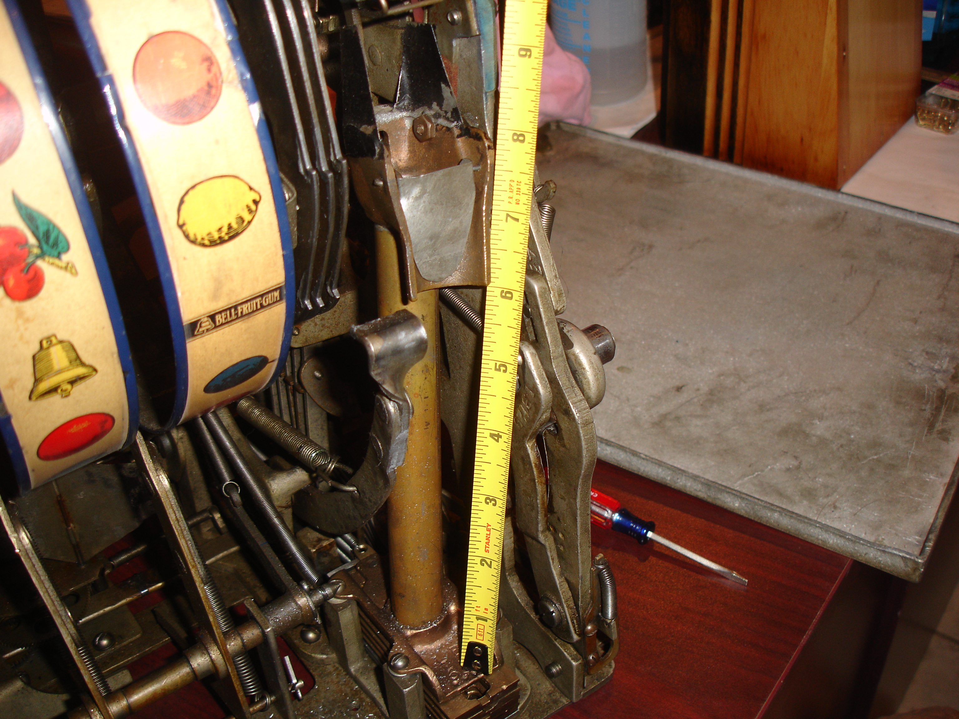

Postby pb4sc » Sun Mar 05, 2017 7:02 pm
Jeff,
Here is a picture of mine....
Hope this helps, Let me know if you need any other measurements.
Phil
Postby JHSS-1944 » Sun Mar 05, 2017 8:07 pm
Phil ;
Thank you for the photos ! these should help me. yep , still working on it a bit.
