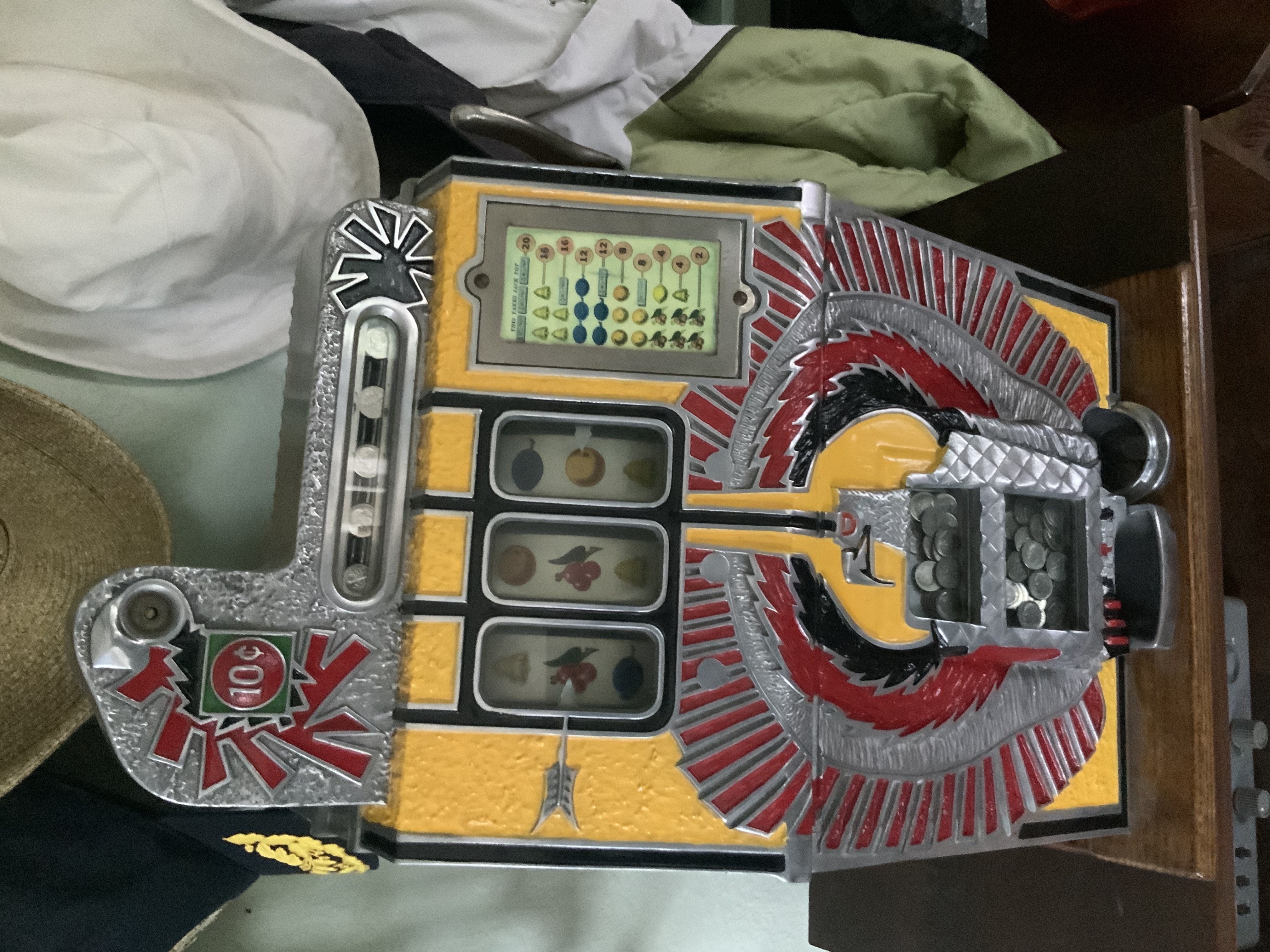

Postby oceanwolf » Tue Apr 14, 2020 10:43 am
I came a cross a Mills War Eagle. I know these are reproduced in the later years. I would not mind a reproduction since it will go to my cabin to be used.
The person who is selling says it is original. But it looks too clean to be original. I want to ask the experts what do they think and what is a fair price.
Thanks All

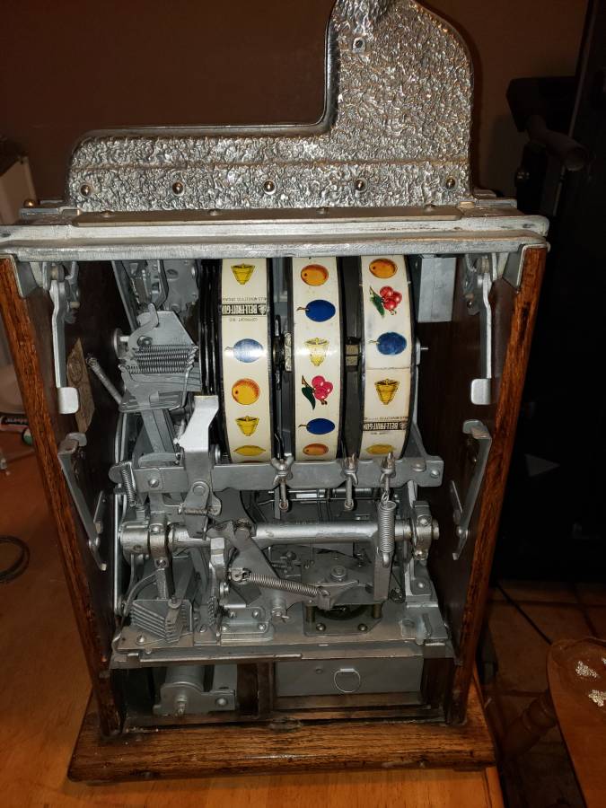

Postby kentdun » Tue Apr 14, 2020 11:23 am
It looks good to me. Most repos are quarter machines. This one has the escalator. It has the pump. Inside the cabinet on the left is a label. Hard to tell, but appears old. Also the wood base has the pins . It still might be a repo. If you search this site there are posts with additional warning signs. What are they asking for the machine?

Postby Dave » Tue Apr 14, 2020 11:30 am
It looks like a very early War Eagle with a 10 stop mechanism with tin litho strips.
It looks legitimate to me.

Postby oceanwolf » Tue Apr 14, 2020 11:30 am
He is asking for $1300. I believe even if this is a reproduction, it is a good price for a mancave machine. If it is the real deal it would be a jackpot for me. :-)

Postby sean duffy » Tue Apr 14, 2020 11:35 am
From my understanding the reproductions didn't have the serial number stamped in the casting to the right of the payout card. Its hard to tell from these photos but it looks like this one has a serial number. most likely legitimate.

Postby oceanwolf » Tue Apr 14, 2020 11:42 am
Dave wrote:It looks like a very early War Eagle with a 10 stop mechanism with tin litho strips.
Thanks Dave. First I found your website, later the youtube video. They were both great help.

Postby oceanwolf » Fri Apr 17, 2020 6:02 pm
It arrived home after 4 hours of driving. Works perfect. I need to figure how to get the cash box out. :-)
Back cover is original with a Mills key.
