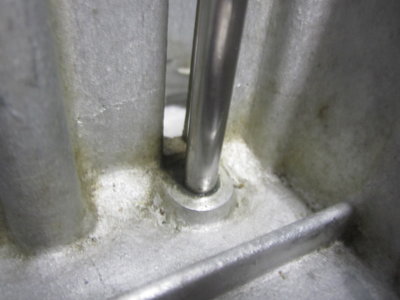

So I have taken the whole machine apart for cleaning and the vertical rod stuck into the base will not come out. I've tried using a lot of PB blaster on it, etc. but its not moving...anyone here ever taken this piece out before? I cant tell if its threaded into the base like a screw or press fit? I have no clue. Any tips would be much appreciated!!

The rod is pressed in, but they usually come out very easy by tapping on the bottom with a punch. Why would you want to take it off? Good luck, George.
