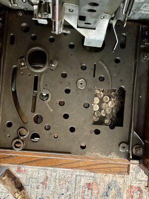

- In the attached pic of the bottom plate, you can see a square has been cut out of an area above the cash box. It was obviously done by a former owner but have no idea what purpose it served. Is this just a one-off situation or was there a reason this area would sometimes be cut out?

Hi Shane-- the chute is part of the check separation assembly. The complete assembly has a spring loaded kicker on the escalator advance bar, which kicks out the nickels or anything without a hole in the middle, the nickels travel down the other chutes to the coin box. The checks travel into the coin tube and jackpot as primary payout. Here's a pic of the other parts (incl your partial chute). I don't believe the payouts are any part of the mystery--it's either something going on with your slides or old dime/new dime issues. The mystery of the castle front was the 3/5 pay--all others to this point were 2/4 pay. I have a couple sets $83.45 ppd for anybody that wants one.

Thanks for the detailed explanation and pic. I wondered how checks and coins were separated.
